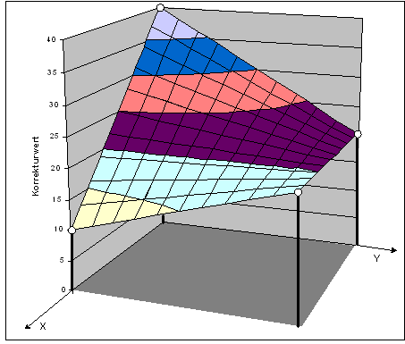

Figure 1-2: Calculation of the compensation value based on the actual positions of the master axes.

The edges of the squares are the interpolation points of the table (shown figure 1-3)
For each interpolation point a compensation value can be defined.
Between two interpolation points linear interpolation is active (shown in figure 1-4).

Plane compensation 4:
Figure 1-4: Linear interpolation between 4 interpolation points of a square
