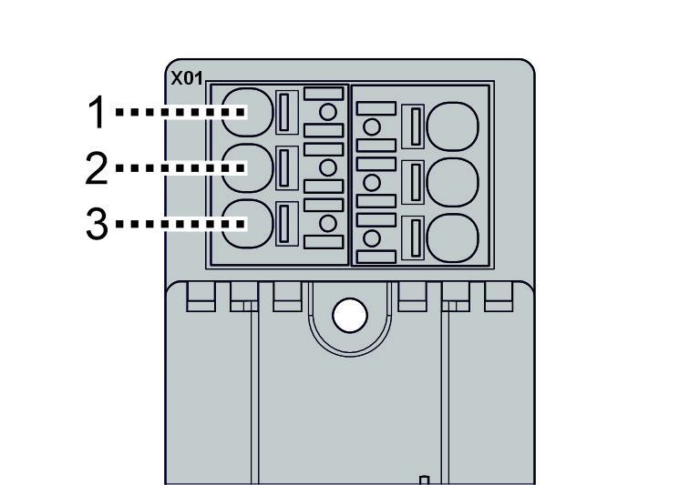

Connection X01
X01 | Mains input for single-phase devices
Feature | Implementation |
Connection type | Connection strip |
Contact type | Direct plug-in technique |
Number of contacts | 3-pin |
Connectable conductors at this connection
Technical parameter |
Unit |
min. |
max. |
Clamping range | mm² | 0.25 | 6 |
Conductor connection cross-section AWG | AWG | 24 | 8 |
solid wire H05(07) V-U | mm² | 0.5 | 6 |
stranded wire H05(07) V-K | mm² | 0.5 | 6 |
with AEH with collar DIN46 228/4 | mm² | 0.25 | 6 |
with wire end sleeve DIN46 228/1 | mm² | 0.25 | 6 |
Strip length | mm | 12 | 12 |
Contact assignment at this connection
Position | Terminal point | Connection |
1 | L | Phase L |
2 | N | Neutral conductor N |
3 | PE | Protective conductor, PE |

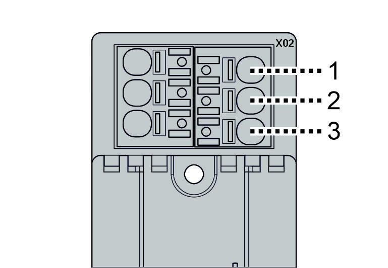

Connection X02
X02 | Mains forwarding for single-phase devices
Unit |
min. |
max. |
1 | L | Phase L |
