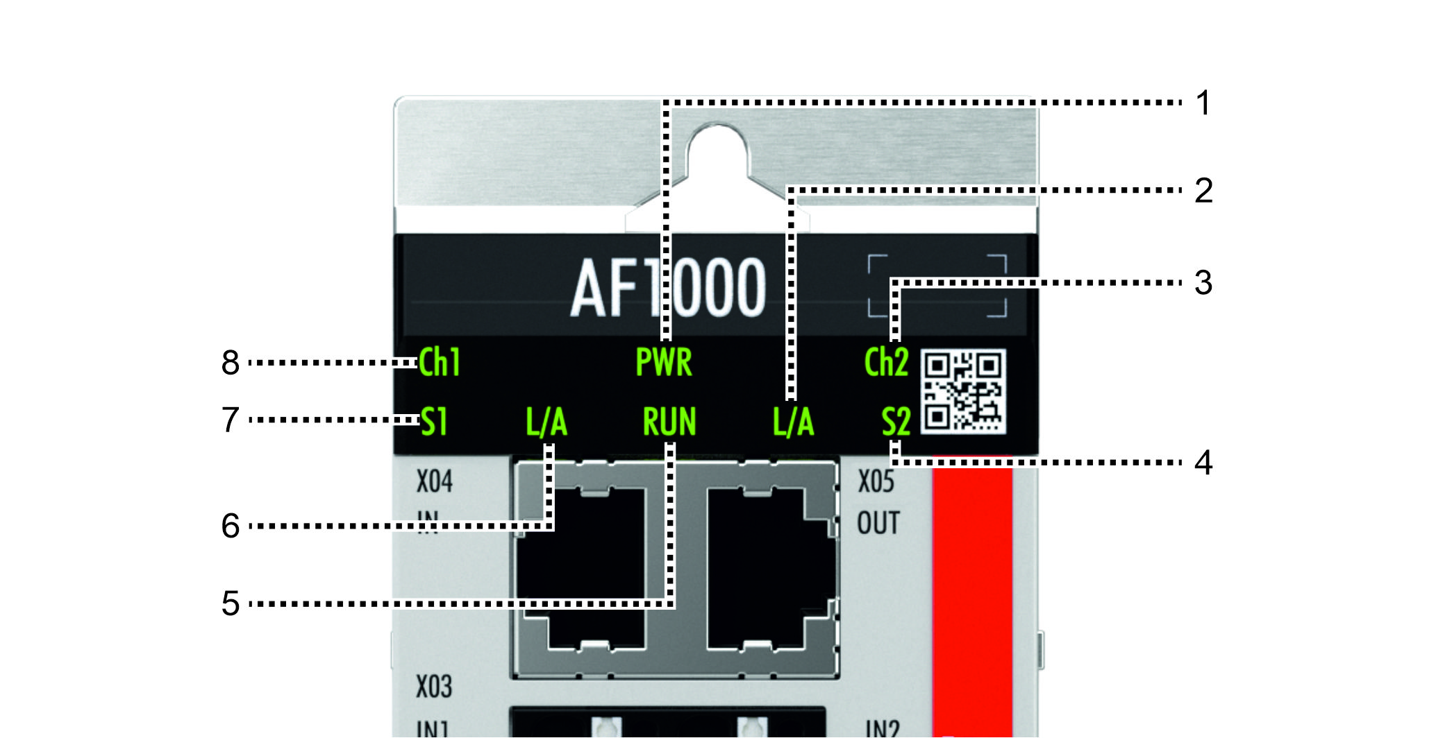

Display
The economy variable frequency drive AF1000 display provides information about the state of the module.
Display 1:
1) for 2-channel modules
2) for modules with TwinSAFE
Item number
Function - designation
Explanation
1
PWR
DC link
2
L/A
Communication OUT X05
3
Ch2
Operating state axis 21)
4
S2
Safety status axis 21) 2)
5
RUN
EtherCAT operating state
6
L/A
Communication IN X04
7
S1
Safety status axis 12)
8
Ch1
Operating state axis 1
Display 2:
DC link status | PWR symbol
LED/status
Status
Off
The module is switched off
Lights up green
DC link charged
Flashes green
DC link is charging
Axis operating state | Ch1 symbol / Ch2 symbol
LED/status
Status
Off
The axis is not active
Lights up red
The variable frequency drive is in EtherCAT INIT status
Flashes red
There is an error
Flashing red and green alternately
An error reaction of the axis is active
Lights up green
The axis is enabled and free from errors
Flashes green quickly
The axis is disabled and is being initialized
Flashes green slowly
The axis is disabled and free from errors
Safety status axis | S1 symbol / S2 symbol
LED/status
Status
Off
Safety is not active
Lights up red
The axis is in “STO” state
Lights up green
There is no safety error
Communication state | L/A symbol
LED/status
Status
Off
No connection to the connected EtherCAT module
Lights up green
Connection to the connected EtherCAT module (LINK)
Flashes green
Communication with connected EtherCAT module (ACT)
EtherCAT operating state | RUN symbol
LED/status
Status
Off
The module is in EtherCAT INIT status
Lights up green
The module is in EtherCAT Operational status
Flashes green steadily
The module is in EtherCAT Pre-Operational status
Flashes green irregularly
The module is in EtherCAT Safe-Operational status
