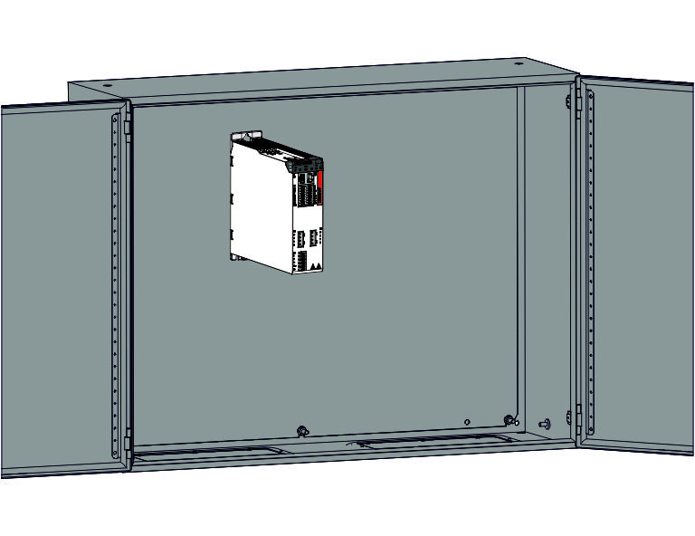

►Install the variable frequency drive in an enclosure that complies with the required protection rating for the installation environment.
►Keep the installation location free of conductive particles (e.g., metal dust, grinding debris).
►Keep the installation location free of corrosive or otherwise chemically aggressive substances.
►Take appropriate protective or cleaning measures if contamination cannot be reliably ruled out, e.g., filtering the ventilation system, regular cleaning.
►Maintain the required clearance above and below the device.
For more information, see Control cabinet installation dimensions.
The standard installation position of the economy variable frequency drive in the control cabinet is the vertical installation position.
Installation location and environment 1:
