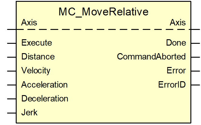

Blockdiagramm des Funktionsbausteins in PLCopen:
Eingangspin | Einheit |
Distance | [0,1µm or 10-4 °] | |
Velocity | [1µm/s or 10-3 °/s] | |
Acceleration | [1mm/s2 or 1°/s2] | |
Deceleration | [1mm/s2 or 1°/s2] | |
Jerk | [1mm/s3 or 1°/s3] |
