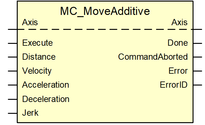

Blockdiagramm des Funktionsbausteins in PLCopen:
Eingangspin
Einheit
Befehl MC_MoveAdditive 1:
Distance
[0,1µm or 10-4 °]
Velocity
[1µm/s or 10-3 °/s]
Acceleration
[1mm/s2 or 1°/s2]
Deceleration
[1mm/s2 or 1°/s2]
Jerk
[1mm/s3 or 1°/s3]
