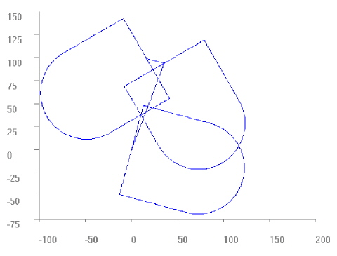

Programmierbeispiel
Drehung in der Ebene (Konturrotation)
%L part
N10 G0 G90 X0 Y0
N30 G1 F5000 Y50
N40 X75
N50 G2 Y-50 R50
N60 G1 X0
N70 Y0
N80 M29
%ang1.nc
N100 G53 G17
N110 LL part
N130 #ROTATION ON [ANGLE -45 CENTER1=10 CENTER2=100]
N140 LL part
N150 G21 (mirroring of X coordinates)
N160 LL part
N170 G18 (warning expected)
N190
M30

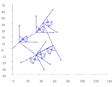

Drehung des Koordinatensystems in der Ebene (#ROTATION ON/OFF) 5:
%L UPRG1
N1 X0 Y0 Z0
N10 X25
N30 X0
N40 Y25
N50 Y0
N60 X10
N70 Y10
N80 X0 Y0
N90 Y10
N100 X10 Y0
N110 G03 I-5 J5 Y10
N120 G1 X0 Y0
M17
%L UPRG2
N2 X0 Y0 Z0
N10 X25
N20 G02 I0.8
N30 G1 X0
N40 Y25
N45 G02 J0.8
N50 G1 Y0
N120 G1 X0 Y0
M17
%L UPRG3
N3 G1 X0 Y0 Z0
N10 X4 Y4
N20 G02 I1 J1
N30 G1 X0 Y0 Z0
M17
%ang4.nc
N1 G1 X0 Y0 Z0 F1000
N500 G92 X10 Y10
N510 LL UPRG1
N520 #ROTATION ON [ANGLE 0 CENTER1 25 CENTER2 15]
N540 LL UPRG1
N550 G92 X20 Y25
N560 #ROTATION ON [ANGLE –35]
N570 LL UPRG1
N580 G92 X35 Y-10
N590 #ROTATION ON [ANGLE=V.G.ROT_ANGLE-117]
N600 LL UPRG1
N610 #ROTATION ON [CENTER1 0 CENTER2 0]
N620 LL UPRG1
N630 #ROTATION ON [ANGLE=V.G.ROT_ANGLE+117]
N640 LL UPRG1
N650 #ROTATION ON [ANGLE=V.G.ROT_ANGLE+35]
N500 G92 X10 Y10
N510 LL UPRG2
N540 LL UPRG2
N550 G92 X20 Y25
N570 LL UPRG2
N580 G92 X35 Y-10
N600 LL UPRG2
N620 LL UPRG2
N640 LL UPRG2
N500 G92 X10 Y10
N510 LL UPRG3
N540 LL UPRG3
N550 G92 X20 Y25
N570 LL UPRG3
N580 G92 X35 Y-10
N600 LL UPRG3
N620 LL UPRG3
N640 LL UPRG3
M30
