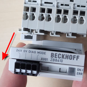

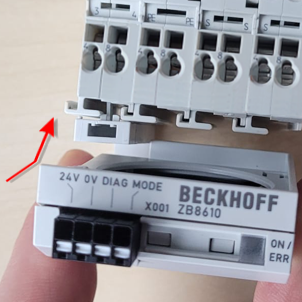

2. Push the fan cartridge onto the holder as shown in fig. "Attaching the fan cartridge". The holding tab and the recess (see fig. "Push fan cartridge with recess over holding tab") on the fan cartridge fit each other and close flush in a downward direction.
Mounting and demounting 6:Fig.8: Attaching the fan cartridge
Mounting and demounting 7:Fig.9: Push fan cartridge with recess over holding tab

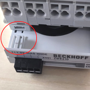

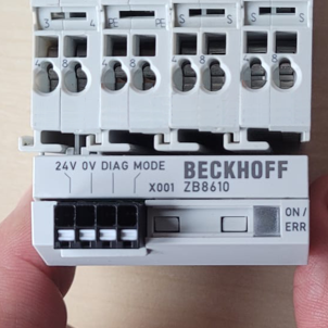

3. Make sure that the latching tab is pushed into the groove until a click noise is heard as in fig. "Push latching tab into groove". The fan cartridge is now correctly attached.
Mounting and demounting 8:Fig.10: Push latching tab into groove
Mounting and demounting 9:Fig.11: Correctly attached fan cartridge, front view
Mounting and demounting 10:Fig.12: Correctly attached fan cartridge, side view
