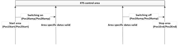

Control Areas
1
Array
Determines the number of Control Areas available. A maximum of 4 control areas can be set. When a control area is enabled and a control loop uses area parameters, when the axis is in an area, the area parameter.
[arrayindex] is Enabled
False
True/False
Enable use of Area Parameter Set. Set to True to enable Area Parameters (Control loops must also be enabled to used area parameters)
[arrayindex] reserved
0
Reserved for future use, do not change
[arrayindex] StartPosition
Valid values are from 0 to the Hardware Modulo. Negative numbers or values larger than the hardware modulo are ignored
0
mm
Linear Location where the Area starts Note: The hardware positions are determined in accordance with the Soft Drive. Hardware Position. Reversing the counting direction of the mover does not reverse the hardware position
[arrayindex] EndPosition
0
mm
Linear Location where the Area ends Again dependent upon Hardware position.
[arrayindex] Transition Length
Valid values are from 0 to half of the defined area.
(StartPosition-EndPosition)/2
0
mm
Ramp distance for linearly switching to/from area parameters.
