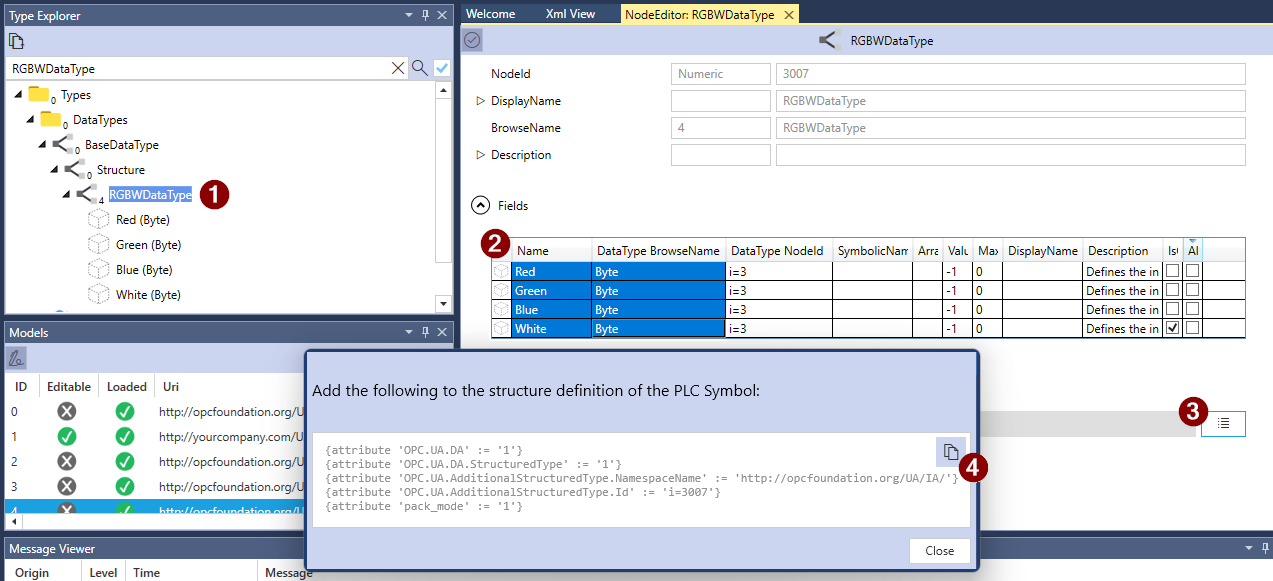

The required attributes can be written manually above the instance or type declaration or retrieved for copying via the TwinCAT OPC UA Nodeset Editor.
Step-by-step with the Nodeset Editor:
  1 - Finding and opening the structure type.

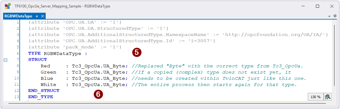

  5 - Creating the DUT in TwinCAT.
  2 – Selection and copying of all names and DataType BrowseNames of the fields
  5 - Insert in TwinCAT between STRUCT and END_STRUCT
  3 - Opening of the pragmas for the type
  4 - Copying the pragmas
  5 - Inserting in TwinCAT above TYPE
  6 - Replacing the DataType BrowseNames with the appropriate PLC types
(e.g. Boolean => "Tc3_OpcUa.UA_Boolean" or "BOOL").
Missing (structure) types may also need to be created.

Meaning of the attributes:
  • OPC.UA.DA
    Activates the provision of the data type and any sub-elements via OPC UA.
  • OPC.UA.DA.StructuredType
    Identifies the type as a structured OPC UA data type.
  • OPC.UA.AdditionalStructuredType.NamespaceName
    Specifies the NamespaceUri of the data type from the nodeset.
  • OPC.UA.AdditionalStructuredType.Id
    Contains the NodeId of the OPC UA data type, in this case i=3007.
  • pack_mode := '1'
    Ensures that the memory layout of the structure is defined and compatible.
