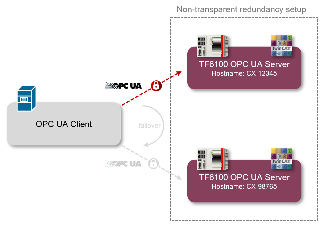

The OPC UA specification defines two types of server redundancy: transparent and non-transparent redundancy. With transparent redundancy, the transfer of functions from one server to another is transparent for the client, i.e. the client does not know that a failover process has occurred and therefore has no control over the failover behavior. In addition, the client does not need to take any action to continue sending or receiving data. With non-transparent redundancy, the failover process from one server to another and the actions to continue sending or receiving data are performed by the client. The client must know the redundancy configuration of the server and perform the necessary actions in order to benefit from the server redundancy in the event of a failover. The non-transparent redundancy defines various failover modes which, among other things, specify how many servers are actively involved in the communication or are available as purely passive systems in the event of a failover.
The TwinCAT OPC UA Server supports non-transparent redundancy with the operation modes "cold", "warm" and "hot". The differences in these three operation modes are explained below.

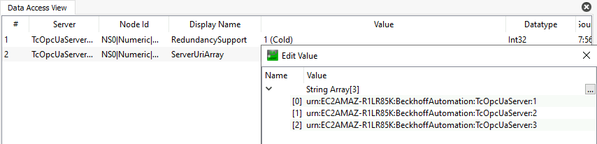

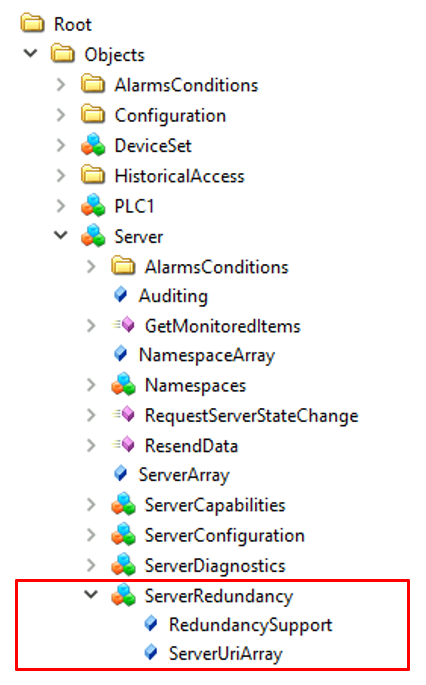

For non-transparent redundancy, OPC UA provides the data structures that allow the client to recognize which servers are available in the redundant server group, as well as server information that tells the client which failover modes the server supports. Based on this information, the client can determine what measures it needs to take to achieve failover. For this purpose, the ServerRedundancy object exists in the server's address space and indicates the redundancy mode supported by the server and the redundancy set, i.e., all servers that are part of the redundancy configuration.

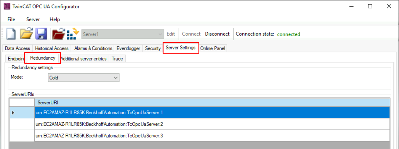

Configuration of redundancy
When configuring server redundancy, you define which Failover mode the server provides and which other servers should be part of the redundancy configuration. These servers are identified via their ServerURI. The Failover mode and a list of ServerURIs are then stored by the server in its ServerRedundancy object (see above).
These settings can be configured via the TwinCAT OPC UA Configurator in the "Server Settings" tab, for example:

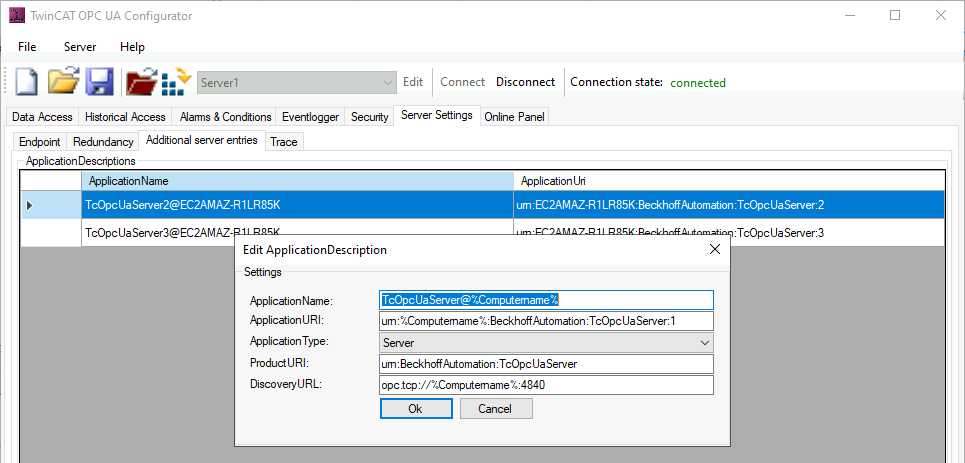

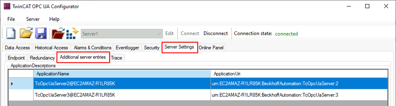

The AdditionalServerEntries can be configured via the TwinCAT OPC UA Configurator in the Server Settings tab, e.g:
When adding a new entry, certain fields are already filled in with a template. Please adjust these entries according to your configuration.

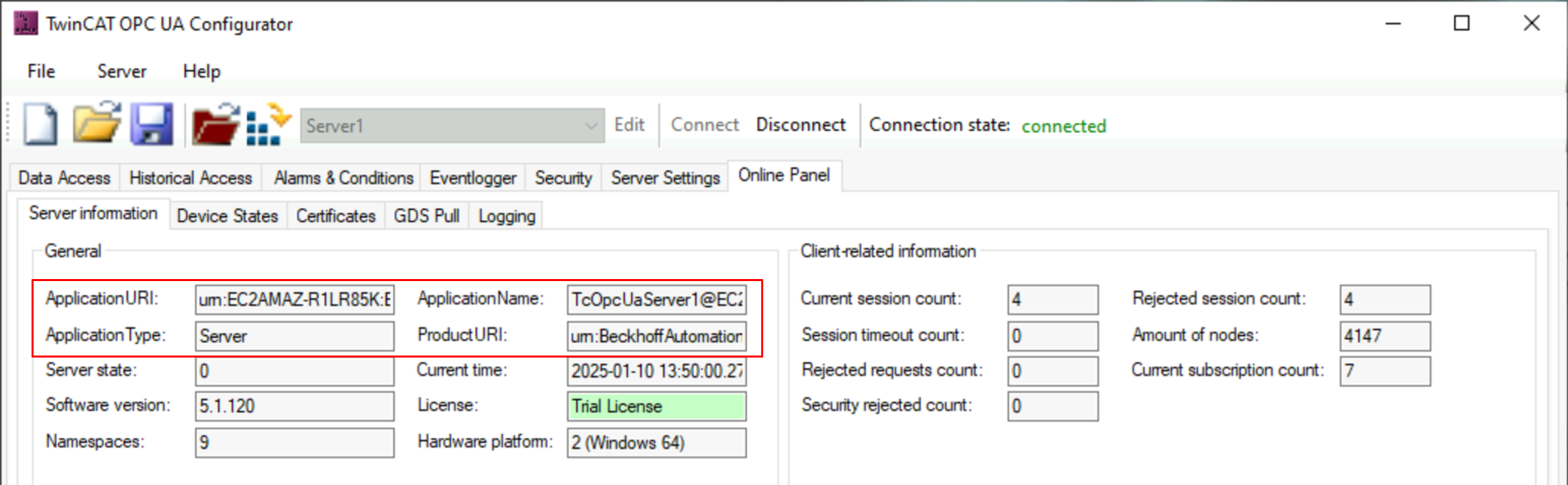

The specific values for ProductUri, ApplicationName, ApplicationUri and ApplicationType can be found in the OnlinePanel of the TwinCAT OPC UA Configurator:
The DiscoveryURL corresponds to the ServerURL that you usually use to connect to the respective server.
