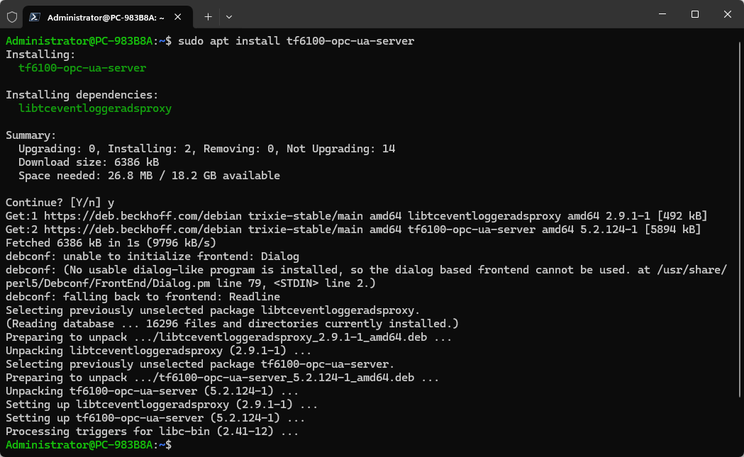

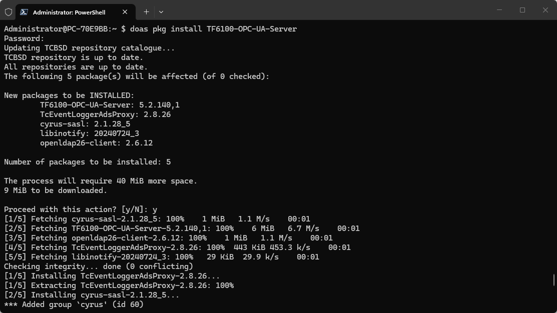

TwinCAT/BSD
If you use TwinCAT/BSD as your operating system, you can install this function via the TwinCAT/BSD Package Server. For further information on the TwinCAT/BSD Package Server and its configuration, please refer to the TwinCAT/BSD documentation.
To search for a package, you can use the following call in the TwinCAT/BSD console:
pkg search TF6100
To install a function, you can use the following call in the TwinCAT/BSD console:
doas pkg install TF6100-OPC-UA-Server-<version>
