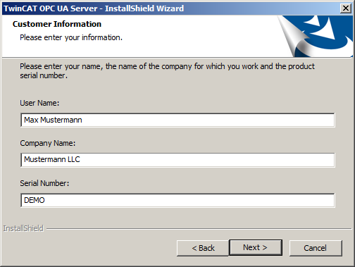

The installation can be done on either the engineering or runtime side, depending on the system you need the supplement for. Please note that under TwinCAT 2, the supplement is licensed directly during installation. A separate dialog prompts you to enter the license key. If you would like to install a 30-day trial version of the supplement, please enter DEMO as the license key.
Installation 1:

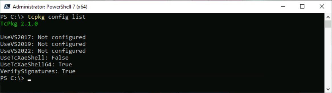

You can use the following TcPkg CLI call to view the current Visual Studio integration settings and adjust them if necessary:
tcpkg config list
tcpkg config set -n UseVS2022
Installation 3:

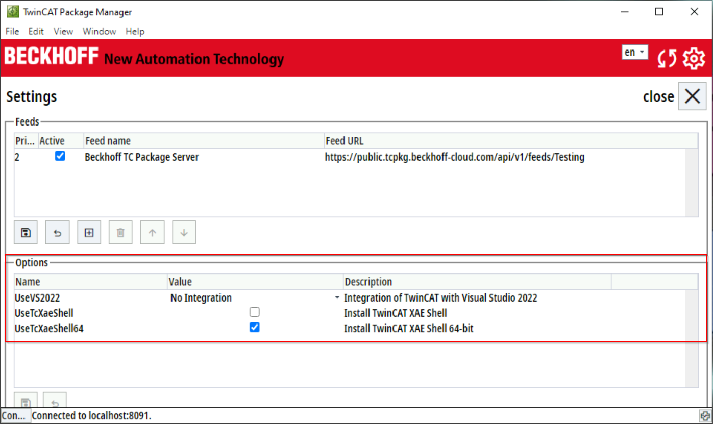

You will also find these settings in the TcPkg UI and can adjust them according to your engineering environment. The following screenshot shows a configuration in which only integration into the TwinCAT XAE Shell (64-bit) takes place.
Installation 4:
