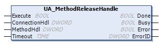

UA_MethodReleaseHandle
This function block releases the specified method handle.
Inputs
Execute : BOOL;
ConnectionHdl : DWORD;
MethodHdl : DWORD;
Timeout : TIME := DEFAULT_ADS_TIMEOUT;
END_VAR Name | Type | Description |
Execute | BOOL | The command is triggered by a rising edge at this input. |
ConnectionHdl | DWORD | Connection handle previously output by the function block UA_Connect. |
MethodHdl | DWORD | Method handle previously output by the function block UA_MethodGetHandle. |
Timeout | TIME | Time until the function is aborted. DEFAULT_ADS_TIMEOUT is a global constant, set to 5 seconds. |
Outputs
Done : BOOL;
Busy : BOOL;
Error : BOOL;
ErrorID : UDINT;
Done | BOOL | Switches to TRUE if the function block was executed successfully. |
Busy | BOOL | TRUE until the function block has executed a command, at the most for the duration of the "Timeout" at the input. The inputs accept no new command as long as Busy = TRUE. It is not the connection time that is monitored but the reception time. |
Error | BOOL | Switches to TRUE if an error occurs while executing a command. The command-specific error code is contained in nErrID. |
ErrorID | UDINT | Contains the command-specific ADS error code of the most recently executed command. |
