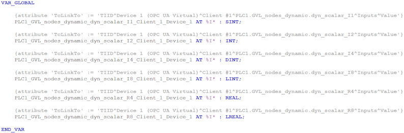

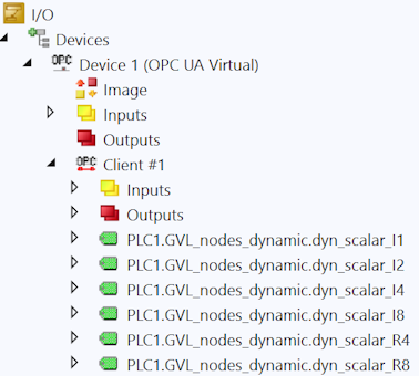

Example: In the I/O part of TwinCAT XAE a TwinCAT OPC UA I/O client with the name "Client 1" was created, to which various OPC UA nodes from a server were added.
Code generation 3:
After calling the code generation, a new GVL with the name "Client_1" was now created in the (already existing) PLC project. This then contains corresponding PLC variables for the individual nodes, which were then automatically linked via the TcLinkTo attribute.

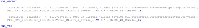

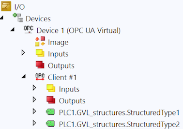

Example: Two StructuredDataTypes from a server were added to the process image of the I/O client. The data types of the StructuredDataTypes on the server are ST_Complex1 and ST_Complex2 (not visible in the screenshot below).
Code generation 6:
The code generation has now created a corresponding GVL with two variables from the respective automatically generated TwinCAT data type, which corresponds to the respective StructuredDataType.

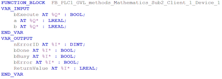

Code generation for methods

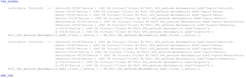

An OPC UA method has input and output parameters which are passed to or returned from the method accordingly. Furthermore, a method is a self-contained call; it must be explicitly started by the client. This methodology is mapped accordingly in the process image of the I/O client at the method and is also taken into account during code generation. For a method, unlike normal variables or structures, a separate function block is created, which is then referenced in the GVL.

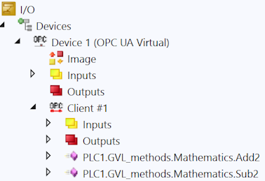

Example: Two methods from a server have been added to the process image of the I/O client.
Code generation 8:
The code generation has now created a corresponding GVL, as well as two function blocks, which represent the input/output and control variables of the respective method.
