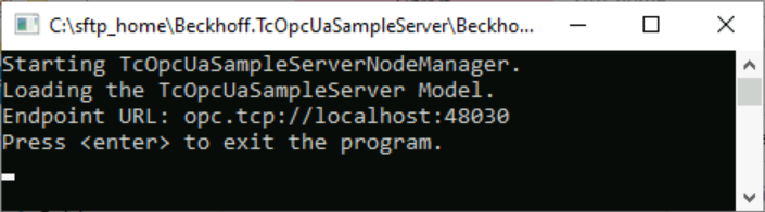

- 1. In Windows Explorer, navigate to the installation directory of the TF6100 FunctionSample and then to the subdirectory "SampleServer".
 - 2. Start the file TcOpcUaSampleServer.exe as administrator.
- The server is started in a console window and can then be accessed at the following OPC UA URL:
opc.tcp://localhost:48030

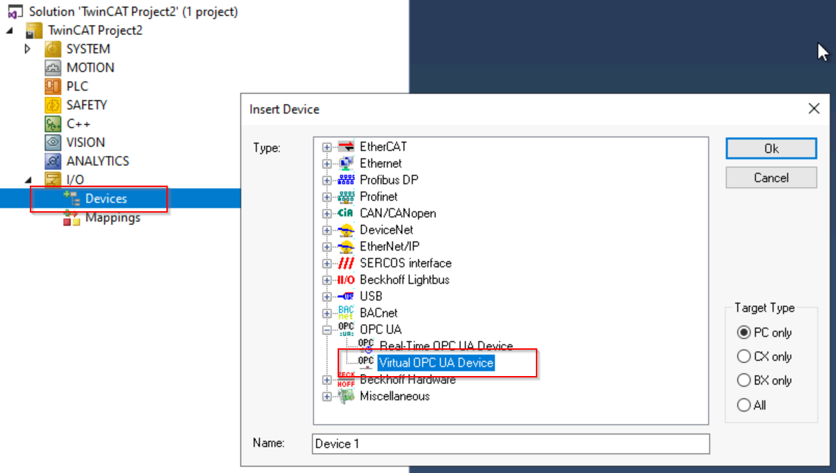

- 1. Add a new I/O device to the TwinCAT project.
Use "OPC UA Virtual Device" as the device type - 2. Add an OPC UA Client to the device

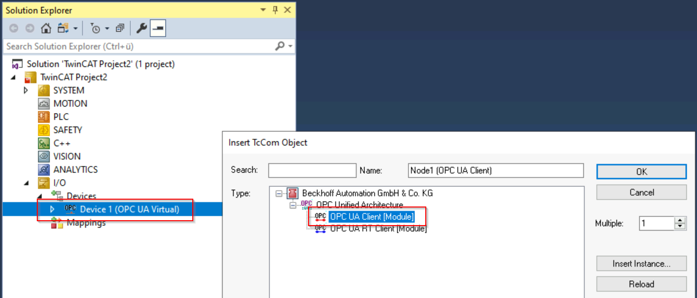

 - 3. Open the settings of the OPC UA Client by double-clicking on the client.

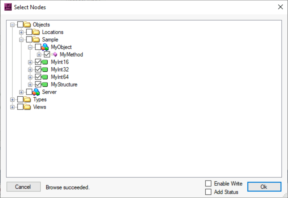

 - 5. Click Add Nodes. A connection to the server is established and the address space of the server is displayed in a separate dialog.
 - 6. Select the nodes shown above and click the Ok button.

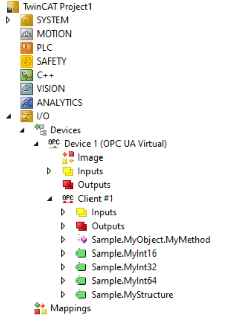

- The variables and the method for the process image of the client have been added.

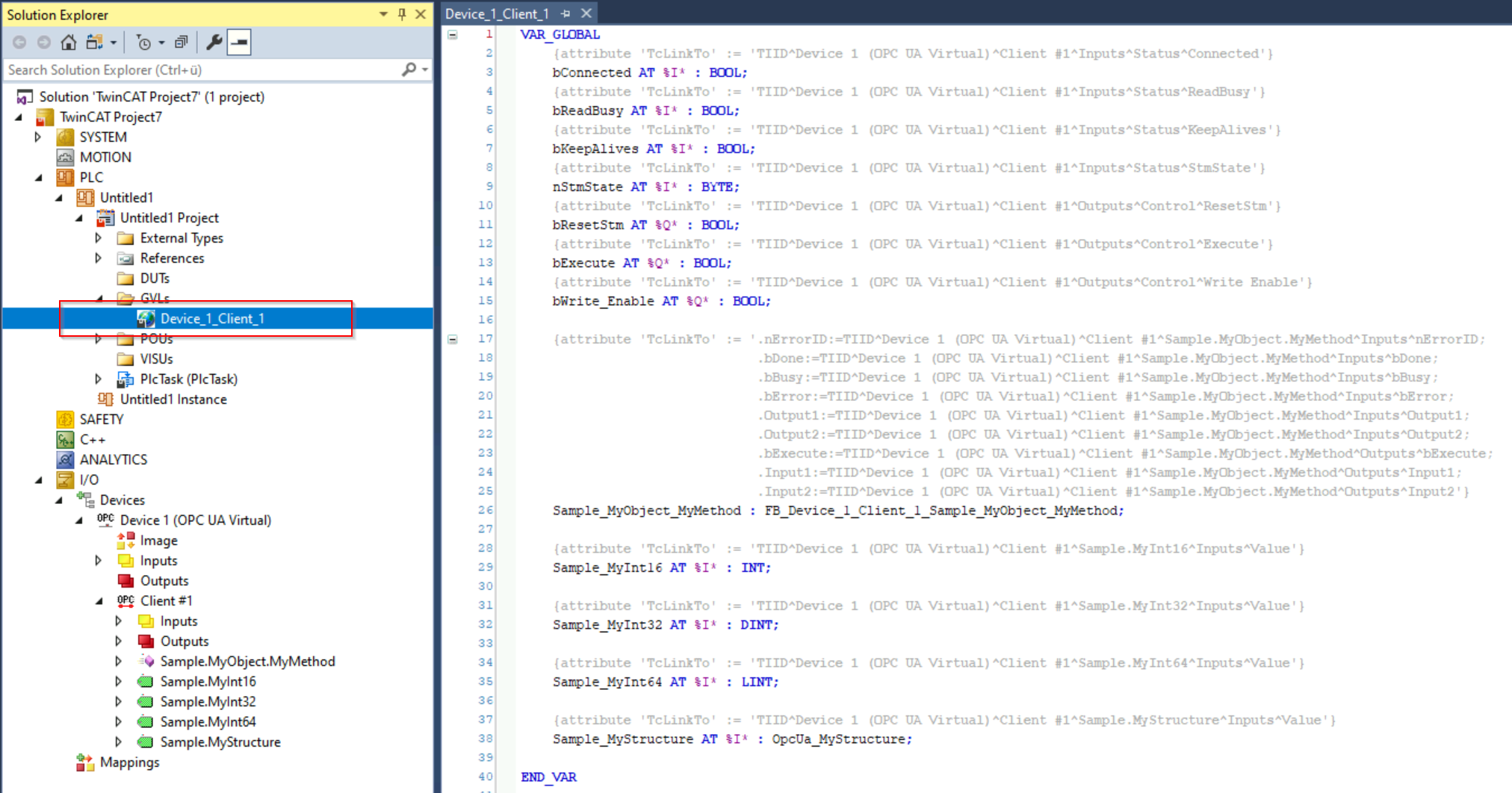

- Automatic code generation should be used to generate PLC variables to match the added OPC UA nodes. The generated PLC variables are automatically linked to the nodes. Alternatively, you can perform the mapping manually.
- 1. Double-click the OPC UA client.
 - 2. In the Settings tab, select the DataType Settings
section.
  - 3. Click the Create Plc Code button, which starts the code generation.
 - The code generator creates a GVL in the existing PLC project whose name is derived from the OPC UA Client device name. PLC variables have now been automatically created within the GVL and linked to the corresponding nodes in the process image of the I/O device via the "TcLinkTo" pragma.
 - 4. Activate the configuration.
- The values of the OPC UA nodes are read from the server and written to the PLC variables via the mapping.
