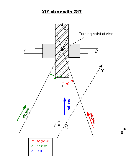

Inclining of the grinding wheel caused by the corresponding entry in the tool list (P-TOOL-00032) is useful only for grinding of inclined surfaces. Here the complete lateral surface of the grinding disc also is in contact.
The following figure shows the orientation of the tilt angle in the G17 plane.
Inclination of grinding wheel 1:
Figure 1-4: Inclination of grinding disc.
With the tilt angle tool orientation is determined.
Over this tool orientation the occured wear is then portioned proportionately on the main axis.
