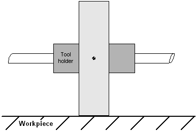

It is presumed that the whole width of the lateral surface of the grinding disc is in contact.
Introduction 1:
Figure 1-1: Grinding of a contour
