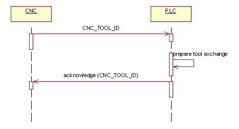

With every programmed T<i> or #TOOL PREP, during NC program decoding the CNC communicates the tool number to the PLC, provided this is activated in the channel parameter list (P-CHAN-00087).
This advance information can be used by the external tool management to prepare a tool change (cleaning the tool, turning the disk changer, etc.) to save time.
The following data (CNC_TOOL_ID) is transferred in the query from the CNC to the PLC; the T number is entered in the basic element:
basic : DINT;
sister : DINT;
variant : DINT;
sister_valid : BOOL;
variant_valid : BOOL;
The PLC acknowledges receipt by returning the identical message.
Information to PLC 1:
Figure1-2: Advance information about tool change to the PLC
