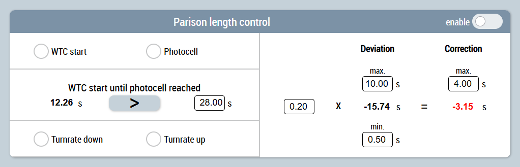

MainExtruder_Settings.content
In addition to the main extruder page, there is also an additional page for the slider area. The page enables parison length control settings.
