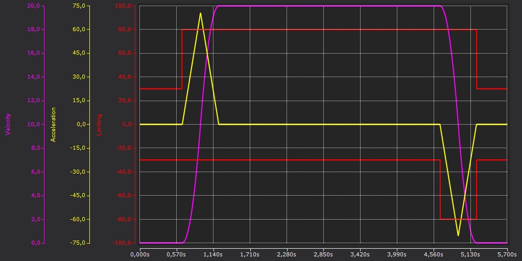

Adaptive | BOOL | Get, Set | The direction of the limit takes into account the set acceleration of the axis. |

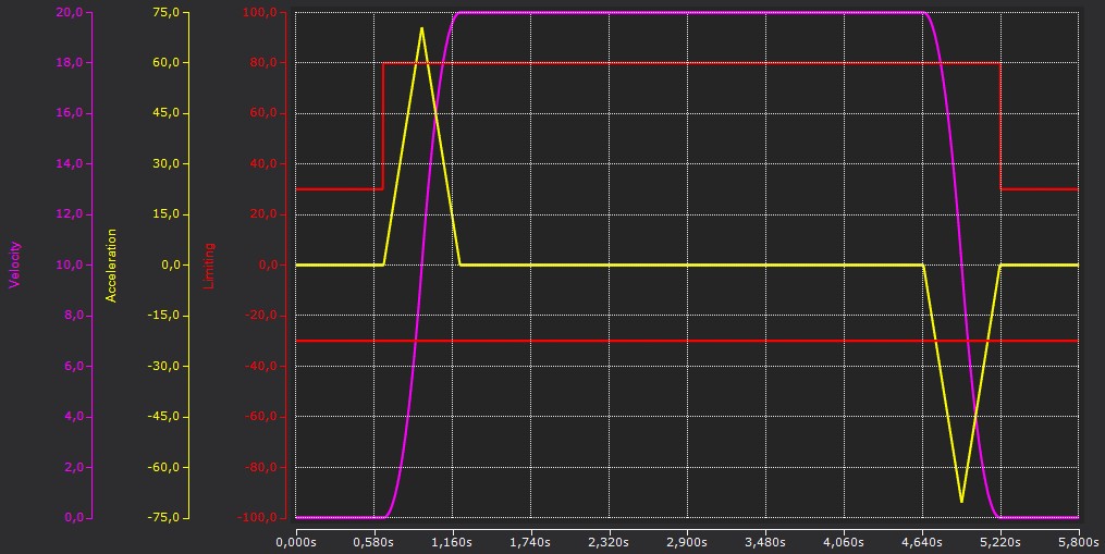

DirectionalFixed | BOOL | Get, Set | The directional application is performed statically in the intended direction of travel. |

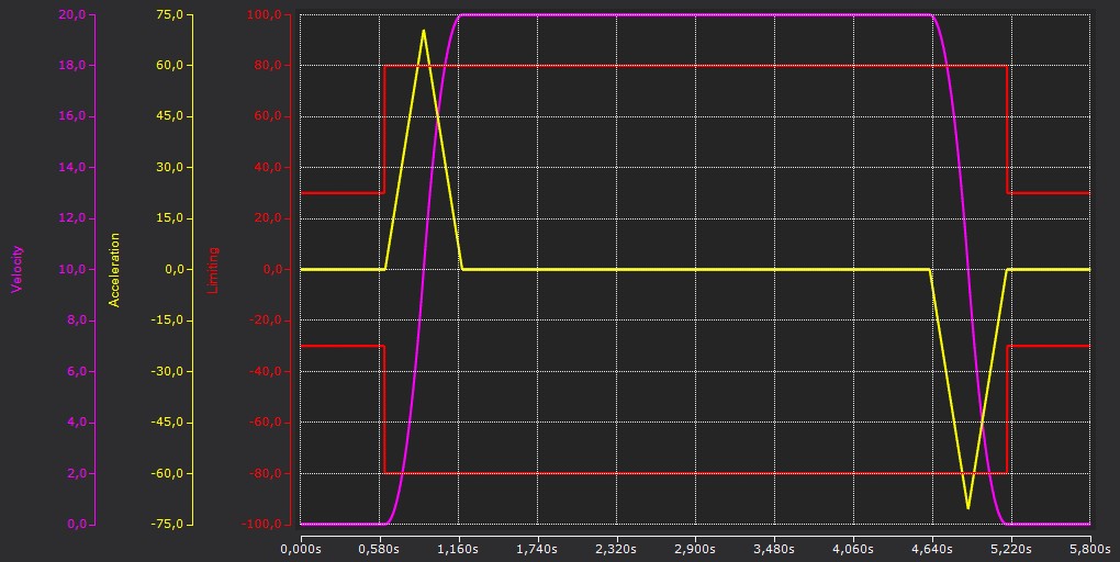

NonDirectional | BOOL | Get, Set | Direction is not taken into account. |
Dynamically adaptive (Adaptive):
The limit adjusts to the current dynamics. When accelerating or traveling at a constant speed, the directional limit is applied in the specified direction. In the event of a deceleration, the directional restriction is also applied in the opposite direction.
Directional (DirectionalFixed):
The restriction applies only to the direction of travel.
Direction-independent (NonDirectional):
Directions are not taken into account and are always applied simultaneously.
