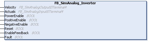

This simulation corresponds to an inverter axis and can be used to replace a real inverter drive by providing compatible mapping elements and emulating behavior very similar to that of a real axis.
The FB offers mapping elements for an analog interface of basic frequency inverters (FU) that match the interfaces implemented by the adapter FB for this drive type. Mapping is done in the same way as for the real drive unit.
Syntax:
FUNCTION_BLOCK FB_SimAnalog_Inverter EXTENDS FB_SimAxCommon
    Velocity               : FB_SimAnalogOutputElTerminal4;   // mandatory
    Actuals                : FB_SimAnalogInputElTerminal4;
    PowerEnable AT %I*     : BOOL;   // mandatory
    PositiveEnable AT %I*  : BOOL;   // optional: will be TRUE if no mapping
    NegativeEnable AT %I*  : BOOL;   // optional: will be TRUE if no mapping
    Reset AT %I*           : BOOL;   // mandatory
    EnableFeedback AT %Q*  : BOOL;
    Fault AT %Q*           : BOOL;
