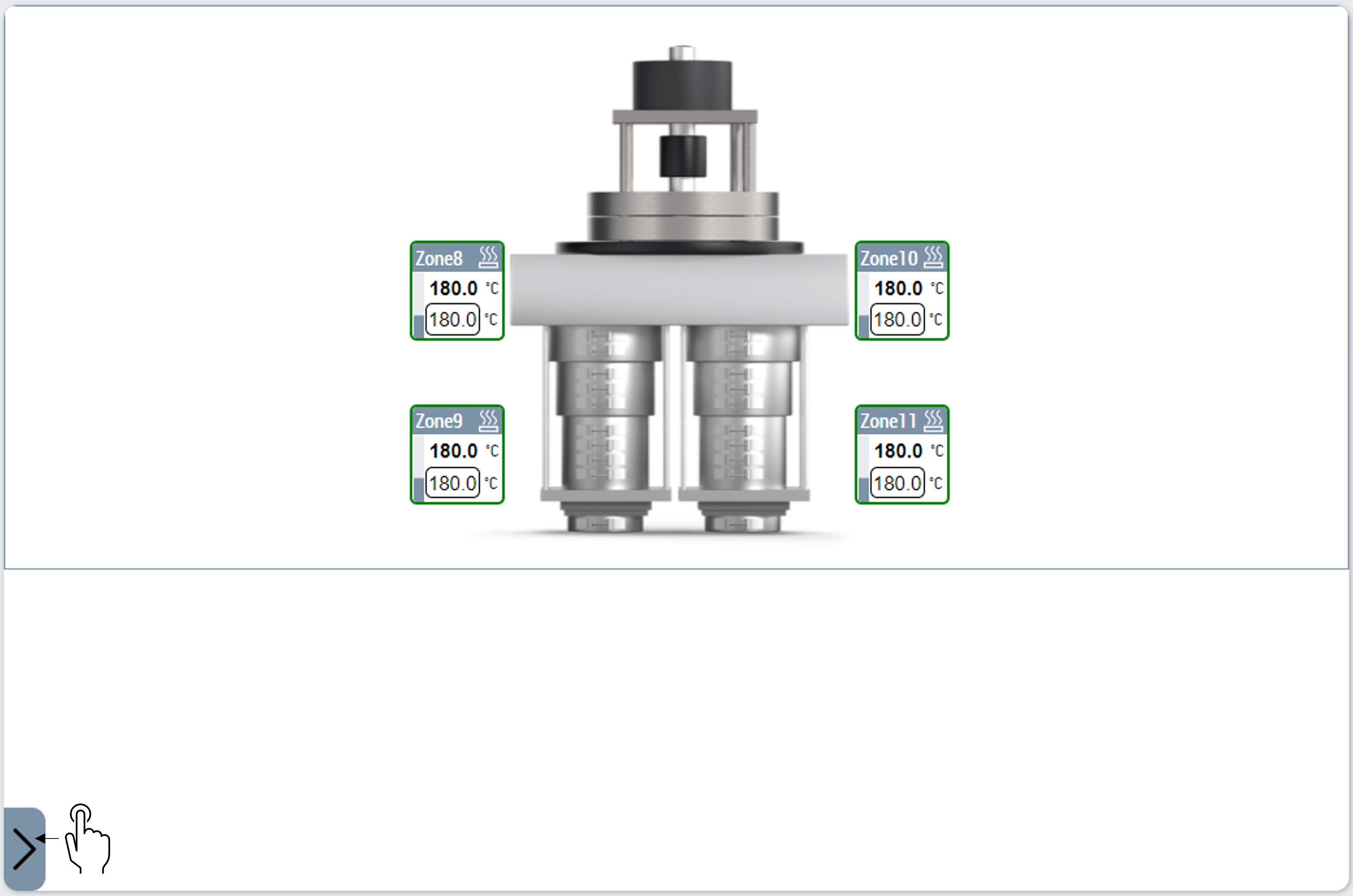

Open zones list panel
To add new zones to the layout or to remove any zone already in layout, the user needs to access the list of temperature zones that are available.
To do this click on the button that opens the zones list.
Open zones list panel 1:
The zones list will list all the available zones in the project. Every temperature channel that is assigned to a temperature group will be listed.
Mode attribute must be set to Config to use this feature. Please check Mode for more information
