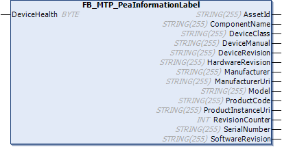

FB_MTP_PeaInformationLabel
FB_MTP_PeaInformationLabel 1:
The function block FB_MTP_PeaInformationLabel is an object that provides information about a PEA during runtime (e.g. via OPC UA). PEA stands for Process Equipment Assembly and is a process technology module. One instance of this object is created per module. The information at the output of this FB is initialized when the FB is instantiated. These values can be read and changed during runtime by a manual operation (e.g. via OPC UA) (see access rights in the variable tables).
FB_MTP_PeaInformationLabel 2:
The variables AssetId, ComponentName and DeviceClass are declared as persistent.
Implemented interfaces
I_MTP_PeaInformationLabel
Type
OPC UA access
TagName
STRING
Name of the interface
TagDescription
STRING
Description of the interface
DeviceHeaIth
BYTE
Summarized WQC at module level (see also WQC)
Read
FB_MTP_PeaInformationLabel 3: Outputs
Type
OPC UA access
Assetld
STRING
Unique ID within a system. This can be specified by the system operator.
Read/write
ComponentName
STRING
Module name within a system. This can be specified by the system operator.
Read/write
DeviceCIass
STRING
The device class can be predefined by the PEA manufacturer. This value can be overwritten by the system operator.
Read/write
DeviceRevision
STRING
Version information of the computer engineering interface. This is executed as a Major.Minor.Patch notation (e.g. 1.2.3).
Read
HardwareRevision
STRING
Version information of the structure of a PEA. This is executed as a Major.Minor.Patch notation (e.g. 1.2.3).
Read
Manufacturer
STRING
Name of the module manufacturer
Read
ManufacturerUri
STRING
Address of the manufacturer's web pages (e.g. www.Beckhoff.de)
Read
Model
STRING
Name of the PEA. This value is identical to the name of the MTP.
Read
ProductCode
STRING
Unique product name of the PEA
Read
ProductInstanceUri
STRING
Unique identifier (URI) of the PEA (according to DIN SPEC 91406)
Read
RevisionCounter
STRING
Revision counter
Read
SerialNumber
STRING
Serial number of the PEA (Assigned by the PEA manufacturer.)
Read
SoftwareRevision
STRING
Version information of the PLC software. This is executed as a Major.Minor.Patch notation (e.g. 1.2.3).
Read
