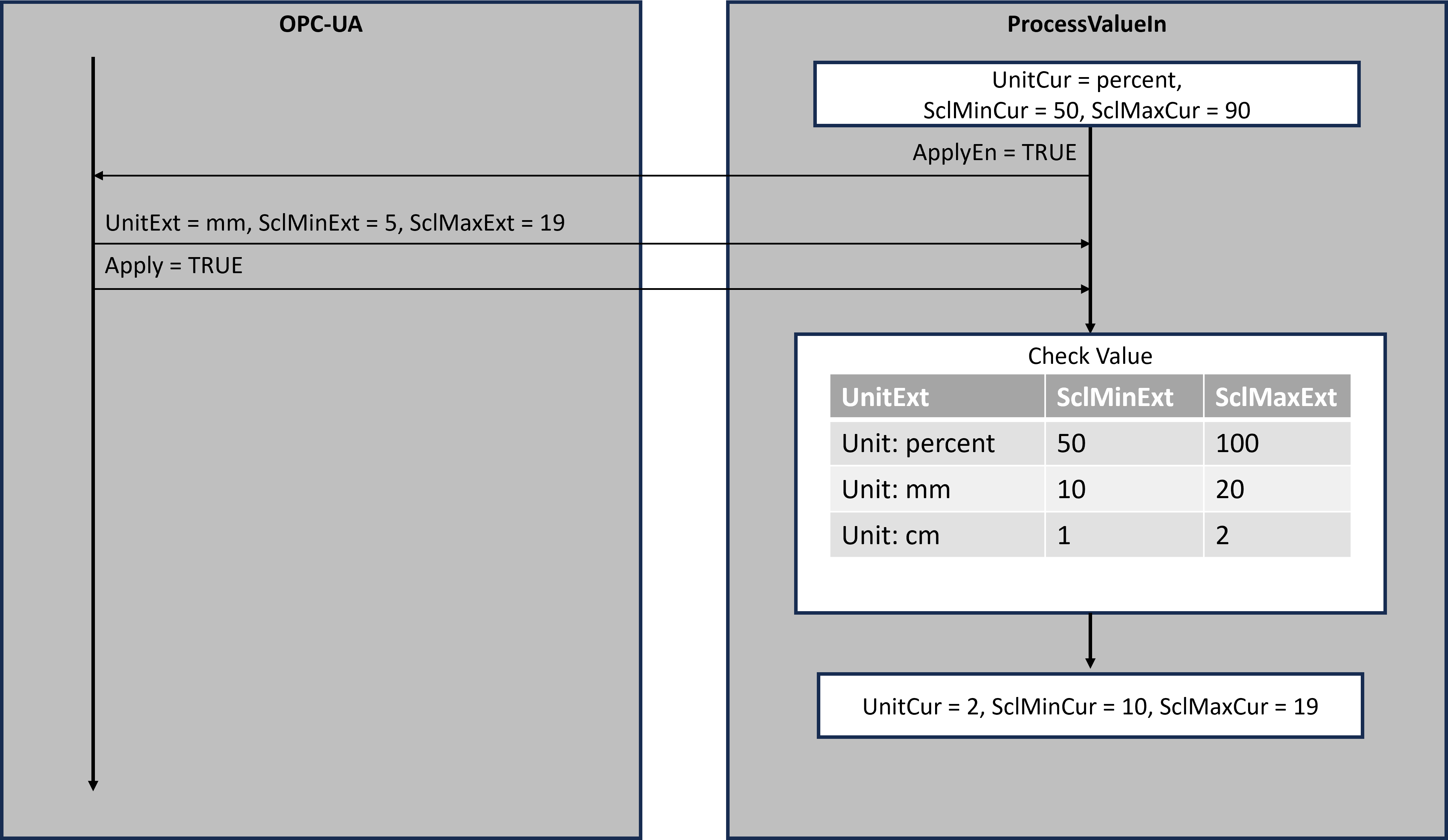

Applying a new configuration
A new configuration is specified via the variables UnitExt, SclMinExt and SclMaxExt.
To change the configuration (unit and value scaling), an array of the type ST_MTP_InputElementConfig with a list of supported configurations is transferred on the PLC side via the input variable Configs. The value scaling for the respective units is stored in this array.
Enabling the application of the configuration is signaled on the PLC side by the variable ApplyEn = TRUE. The application can then be requested via the variable Apply = TRUE.
During the application, UnitExt is compared with the stored possible limit values in Configs. If the limit is exceeded or not reached, the stored upper or lower limit value is used.
