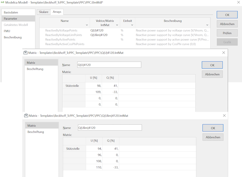

Vendor annotations
are used for arrays in the FMU to map tables (see Tables). In PowerFactory, these can be displayed as two-dimensional matrices and integrated as follows.
