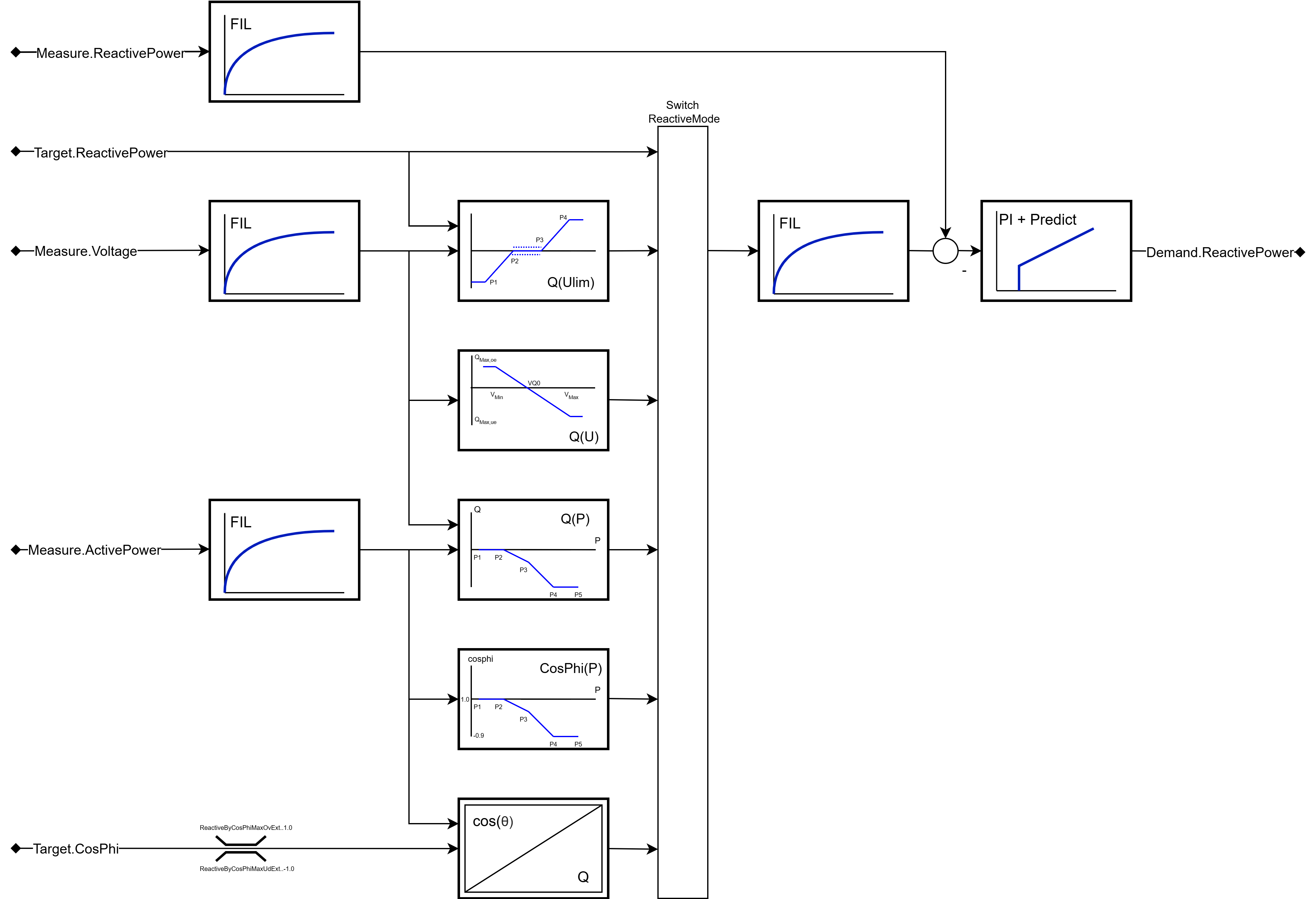

Block diagram
The following figure shows the basic structure of the reactive power controller:
