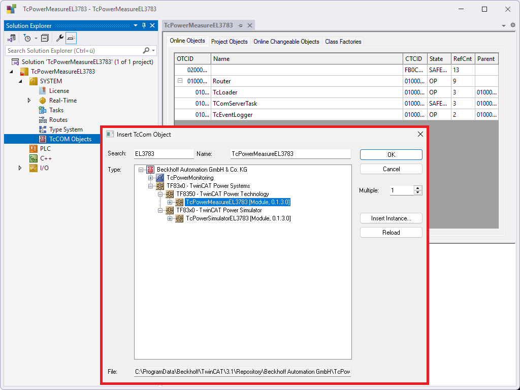

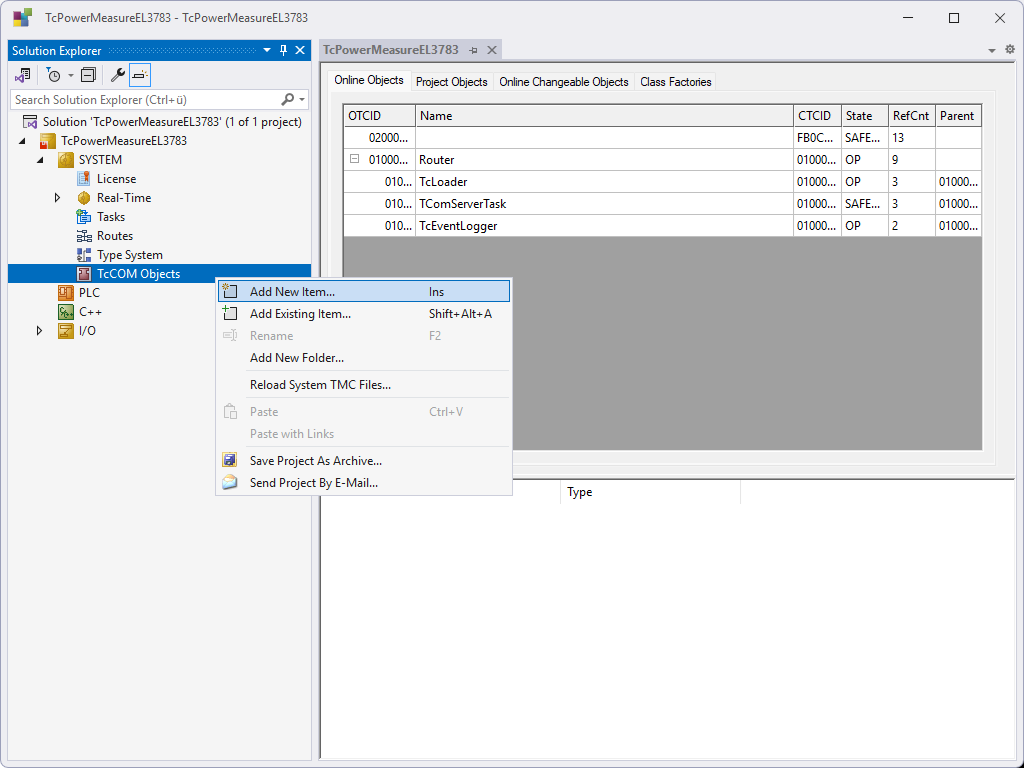

- 1. Right-click on TcCOM Objects in the Solution Explorer and select Add New Item....
- You have added a new module.
- 2. Use the search input field (Search) of EL3783 to choose the TcPowerMeasureEL3783 module.
- 3. Assign a name and click the OK button.

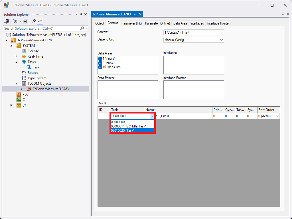

- 4. Assign a task with a cycle time of 1 ms to the module in the Context > Result tab.

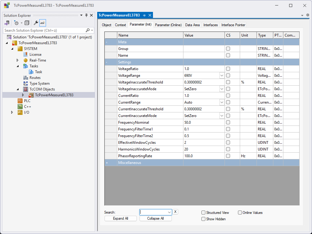

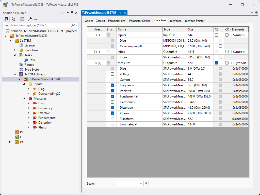

- 5. Make the required settings for the module, terminal and data processing in the Parameters (Init) tab.
- 6. Activate the desired measurement data in the Data Area > Measures tab using the Enable checkbox (see Measure).

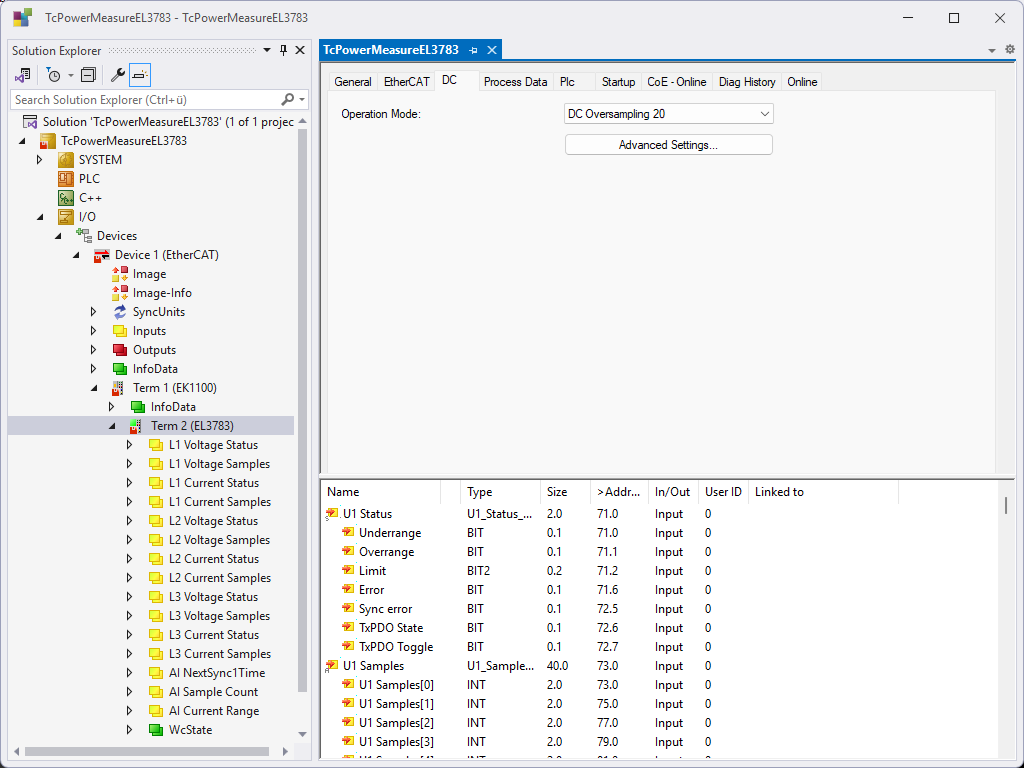

- 7. Select the EL3783 in the project tree of the Solution Explorer under I/O > Devices.

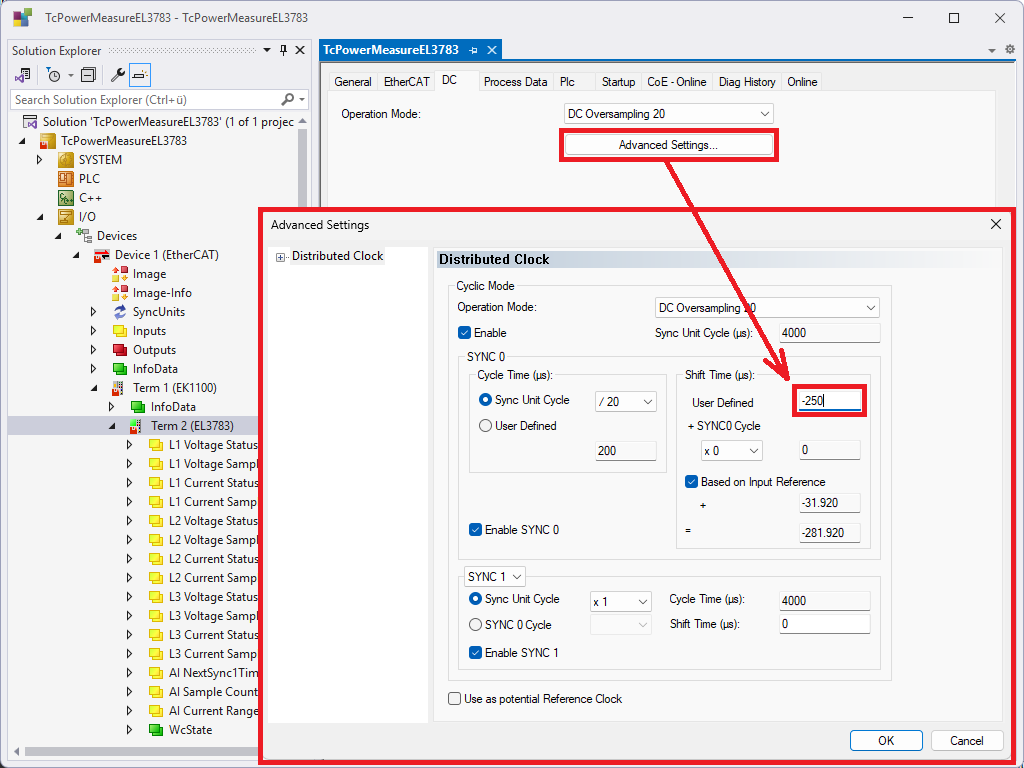

- 8. In the DC tab, select "DC Oversampling 20" as the Operation Mode.

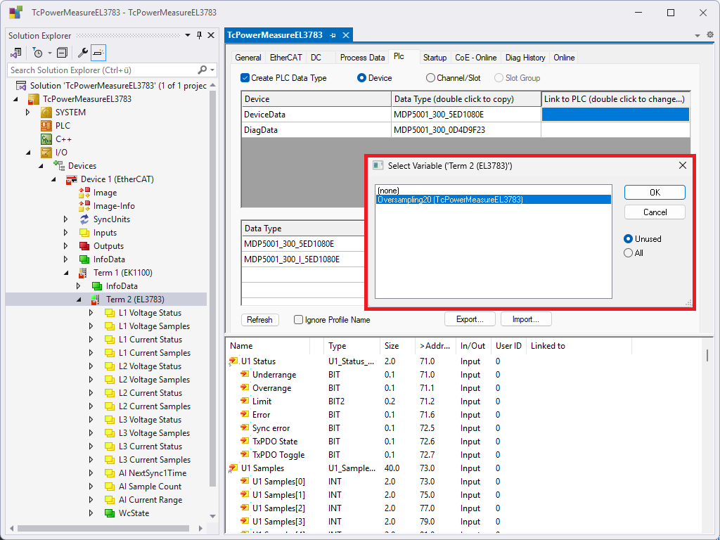

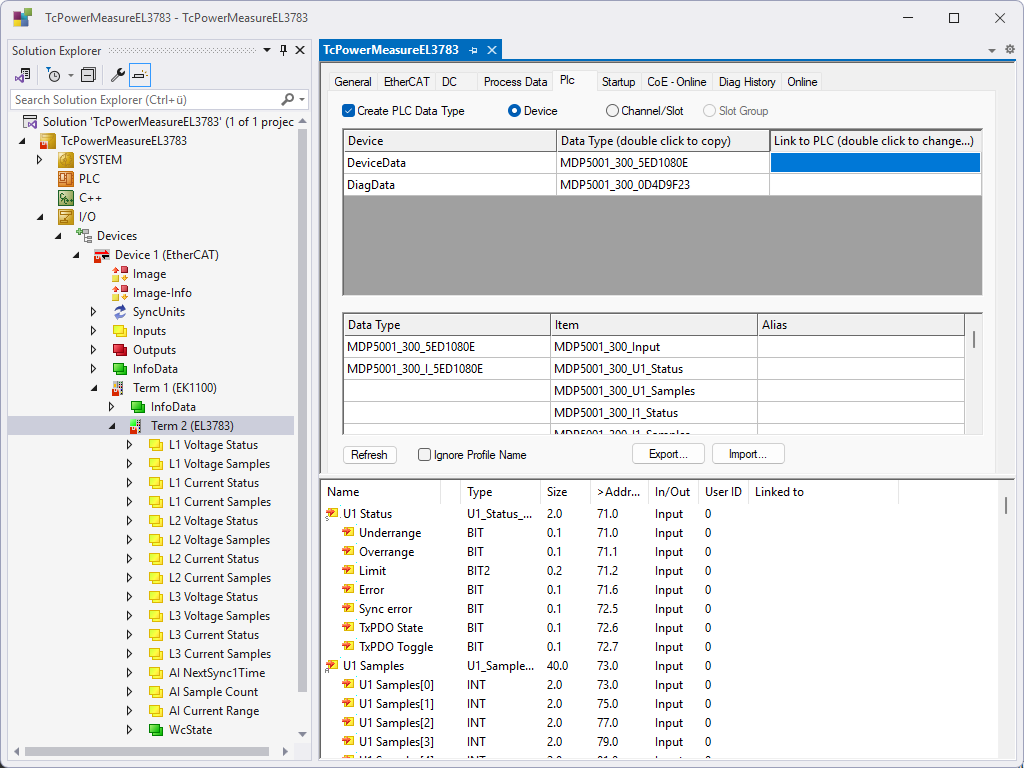

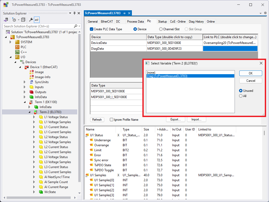

- 9. In the PLC Create PLC Data Type tab, activate .
- 10. Select the option Device.
- 11. Double-click on Link To PLC... to create the link.
- 12. Link process data via DeviceData to the Oversampling20 area of the TcPowerMeasureEL3783 module.
- 13. Link diagnostic data to the area Diag of the TcPowerMeasureEL3783 module using DiagData.
- 14. Depending on the utilization of the real-time and the EtherCAT system, adjust the User Defined Shift Time under Distributed Clocks.
