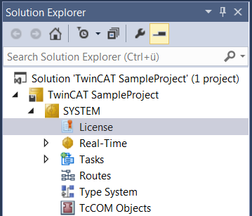

4. In the Solution Explorer, double-click License in the SYSTEM subtree.

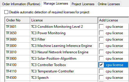

5. Open the Manage Licenses tab. In the Add License column, check the check box for the license you want to add to your project (e.g. "TF4100 TC3 Controller Toolbox").

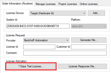

6. Open the Order Information (Runtime) tab.
In the tabular overview of licenses, the previously selected license is displayed with the status “missing”.
7. Click 7-Day Trial License... to activate the 7-day trial license.
