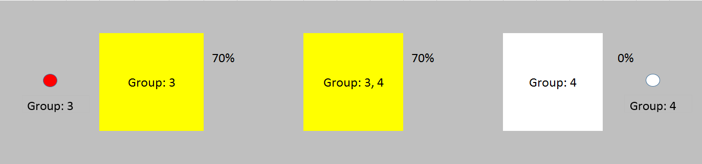

All lamps can be assigned to several groups. The light intensity is determined by the highest light value of all groups:
Three individual lamps can be seen in the first illustration. The set value of group 3 is 70% while that of group 4 is 80%. The basic value of both groups is 30%. One group is assigned to each of the sensors (group 3 and group 4).
Groups 1:
In the next illustration, the sensor in group 3 detects presence. As a result, the lamps in group 3 are set to the set value 70%.

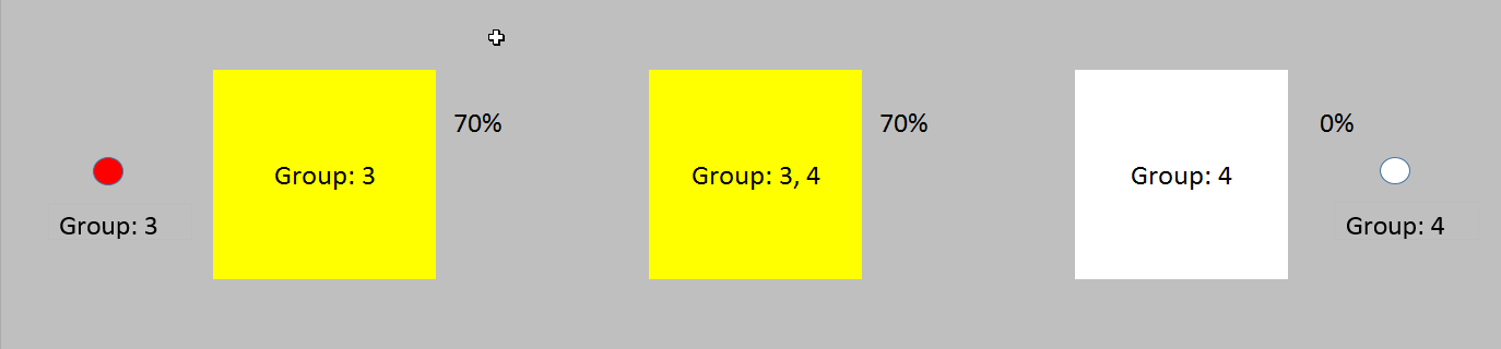

Groups 2:
The sensor in group 4 now also detects presence. The lamps in group 4 are set to the set value 80%.

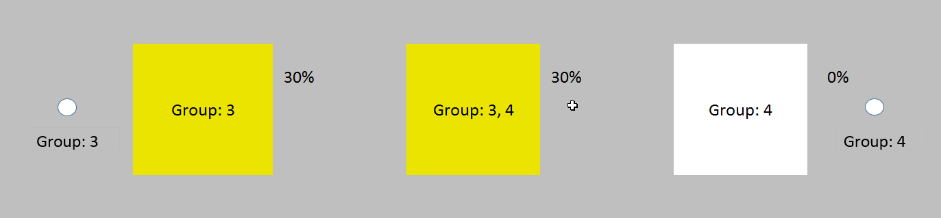

Groups 5:
In the last illustration, group 3 no longer has presence and the 1st overrun time has expired. The left-hand and middle lamps are set to the basic value. On expiry of the 2nd overrun time these are also switched off.
