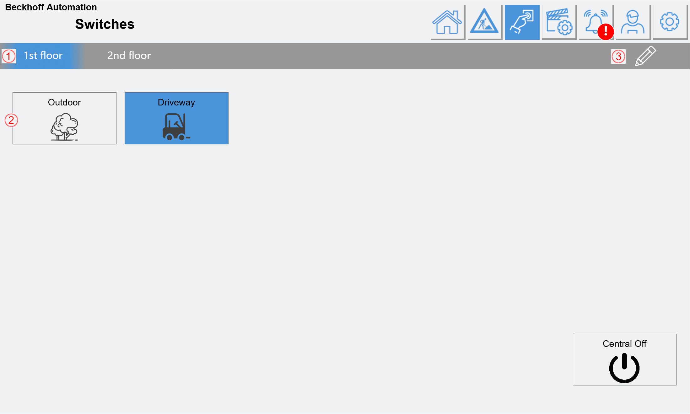

There are buttons that have been configured accordingly in the settings. The display can be activated and its appearance / position on the button side can be set for each button used.
Touch control 1:
(1)   Depending on the selection, up to four button pages are displayed, between which you can switch here.
(2)   Button configured: Feedback in blue.
How the individual buttons are configured is explained in the "IO configuration" chapter.
(3)   Button that enables/disables the editing mode. If it is active, the names of the button pages (1) can be changed with a click.
