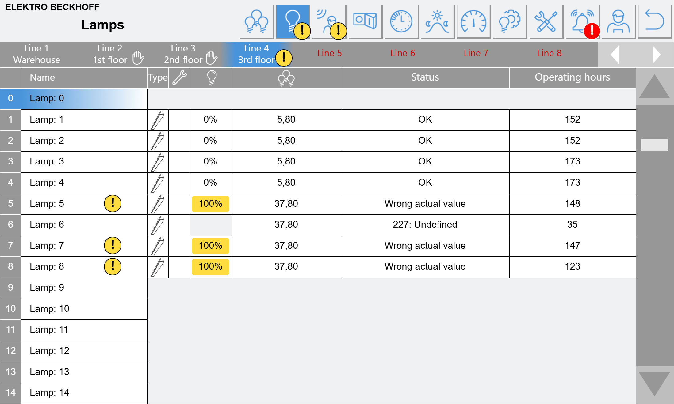

Warnings 1:
Such a warning is displayed for the lamps if they do not accept their set dimming value after several attempts.
This can happen if a corresponding parameter in the control gear is set incorrectly.
In this example, the maximum value of the lamp is below the setpoint of 100%:

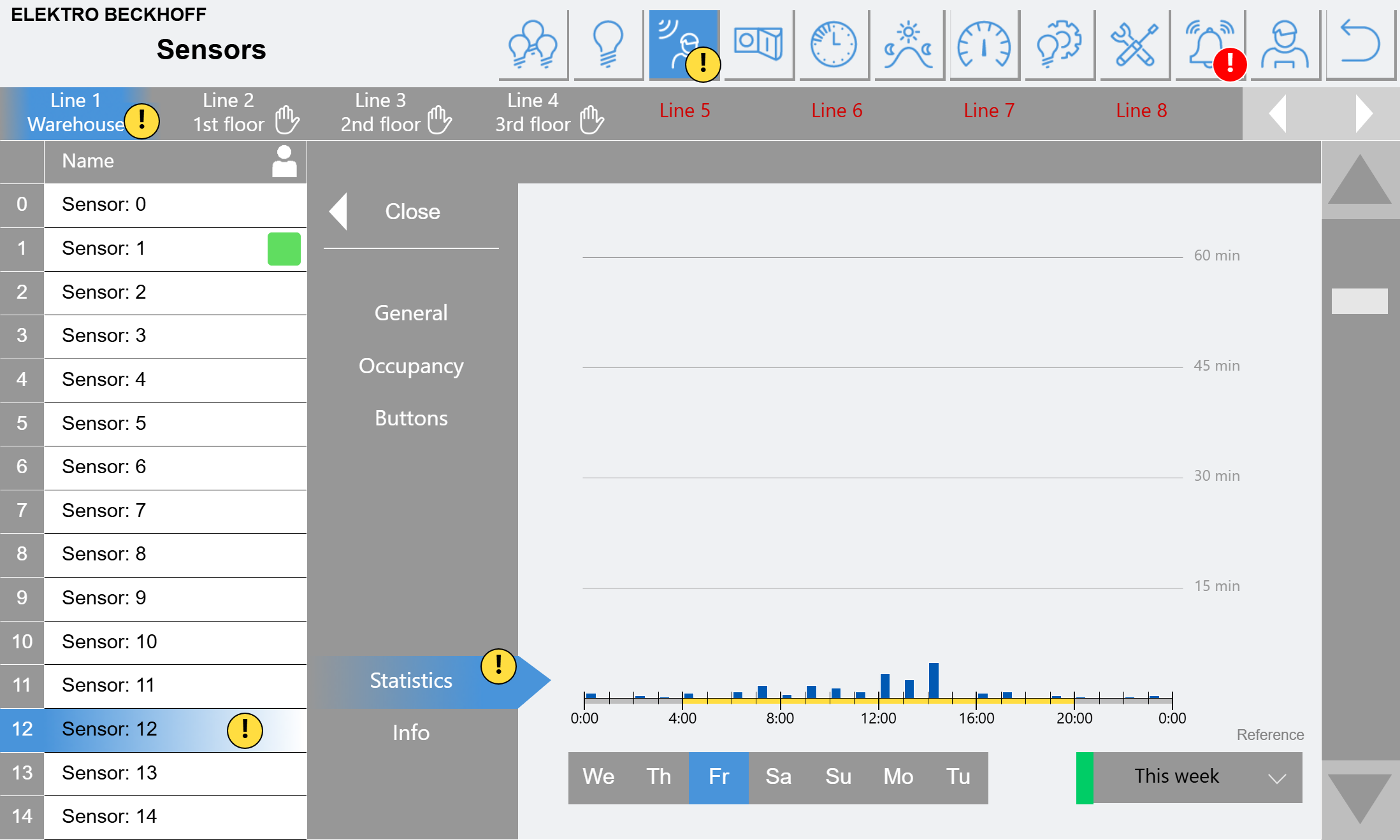

Warnings 2:
In the case of the sensors, a daily check is carried out to see whether a sensor has detected a presence outside the set operating time (yellow bar).
If this is the case, this warning is issued and you must evaluate it yourself by taking a look at the "statistics".
The following example shows a defective sensor that provides such a false presence on a daily basis.
Warnings 3:
The check for this error can be disabled separately for each sensor.
