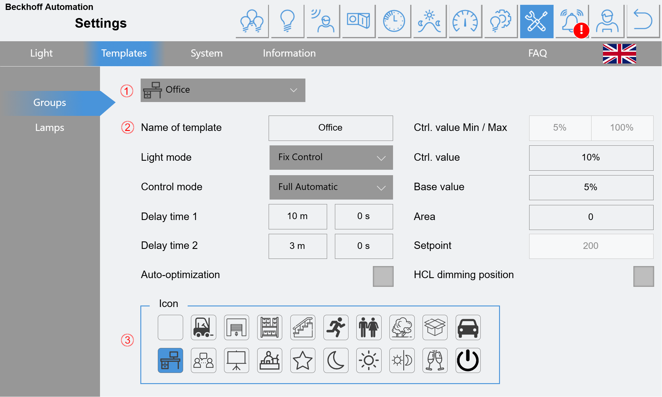

Various lamps and group configurations can be predefined here. It is advisable to start here first during construction, as this makes setting up the individual groups and lamps easier. Subsequent changes to parameters can then be made here for many groups and lamps at the same time. Each of the changes in the individual templates are transferred to all assigned groups and lamps.
Groups:
Templates 1:
(1)  Selection of the template (1-10).
(2)  The name of the template can be edited here.
All other parameters shown here are described in detail under Group configuration.
(3)  Here you can select an icon to be displayed in the drop-down menu (1) and the group table.

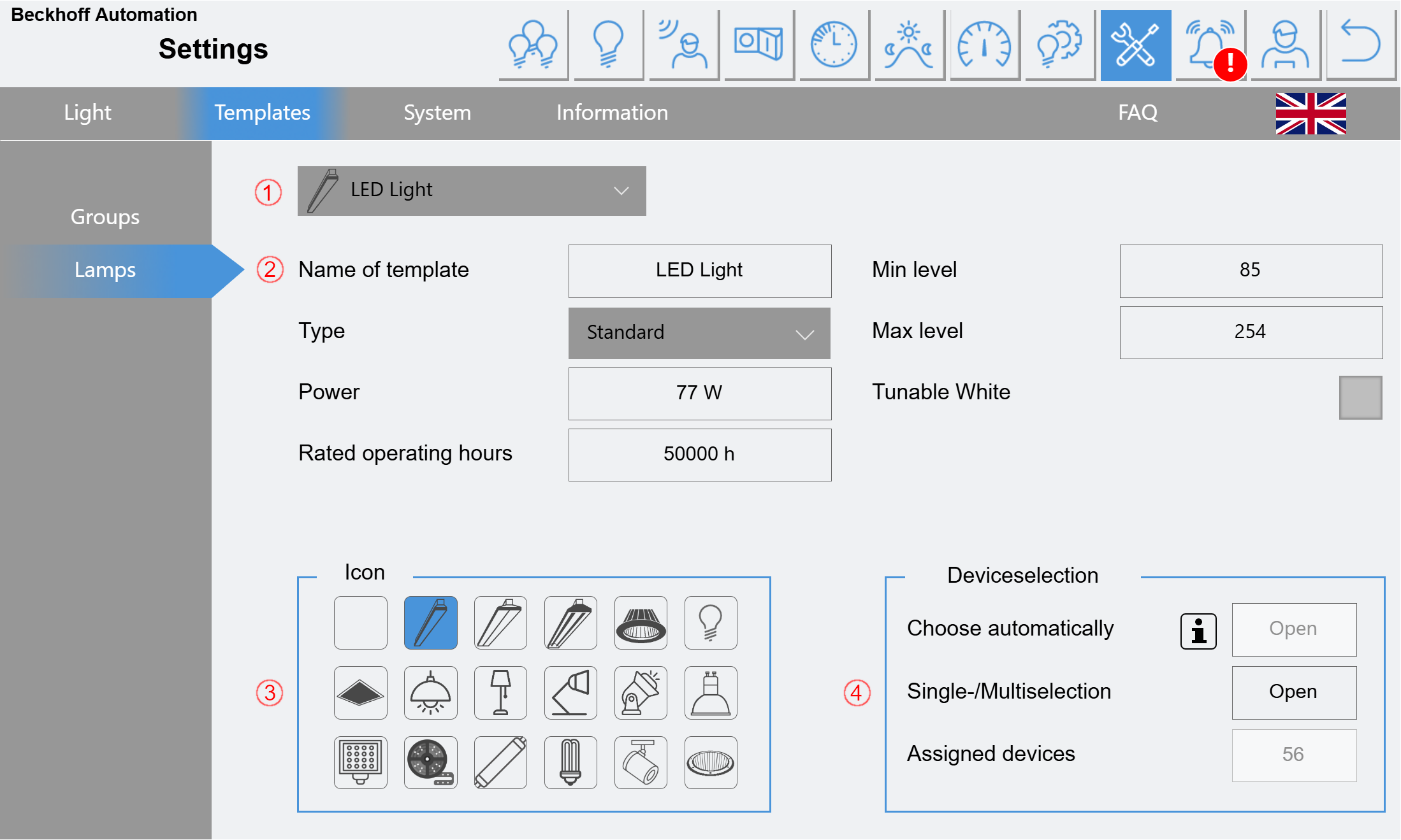

Lamps:
Templates 2:
All other parameters shown here are described in detail under Lamps configuration.
(3)  Here you can select an icon to be displayed in the drop-down menu (1) and the lamp table.
(4)  Individual or multiple lamps can be quickly assigned to the selected template here.
