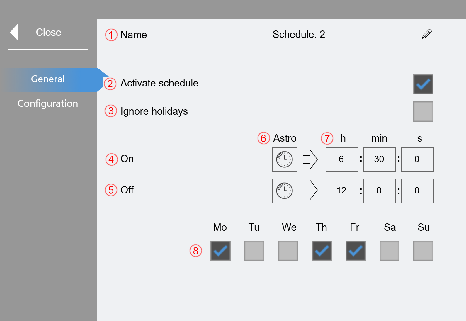

The submenu can be opened by clicking on the name field in the table. The selected row is highlighted in blue in the table. In the menu that opens, you can adjust all settings for the respective schedule.
General:
"Schedules" submenu 1:
(1)  The displayed name can be edited here.
(2)  Activate schedule. Only active schedules are processed by the program.
(3)  If this function is activated, the schedule is ignored on holidays.
(4)  Switch-on point
(5)  Switch-off point
(6)  Click on the symbol to switch from "Time" to "Dawn" or "Dusk" (astro function). The corresponding switching time (7) is then calculated daily using the set coordinates.
(7)  Switch-on/switch-off times can be specified here. If the astro function (6) is activated, the input fields are disabled.
(8)  Selection of weekdays on which the schedule is active

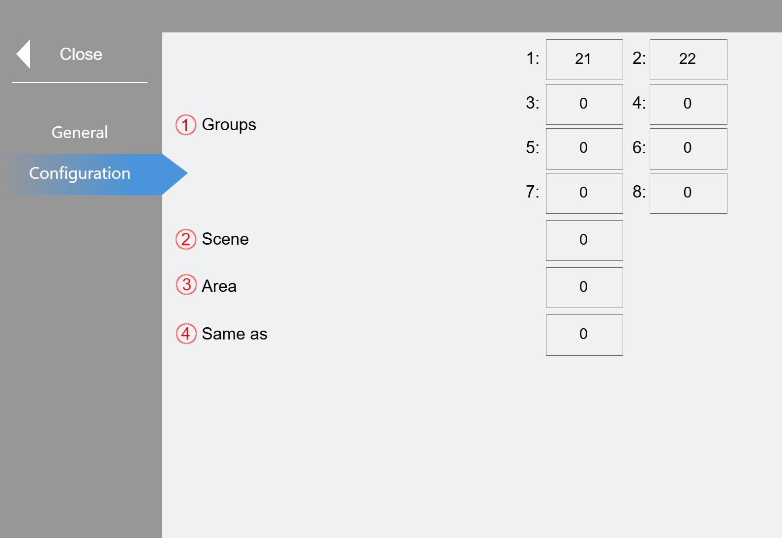

Configuration:
"Schedules" submenu 2:
(1)  Enter the groups to be switched.
(2)  Enter the scene to be switched.
(3)  Enter the area to be activated.
(4)  A number of another schedule can be specified here. If this is the case, the selected one behaves like the one specified here (can be used to switch more than 8 groups).

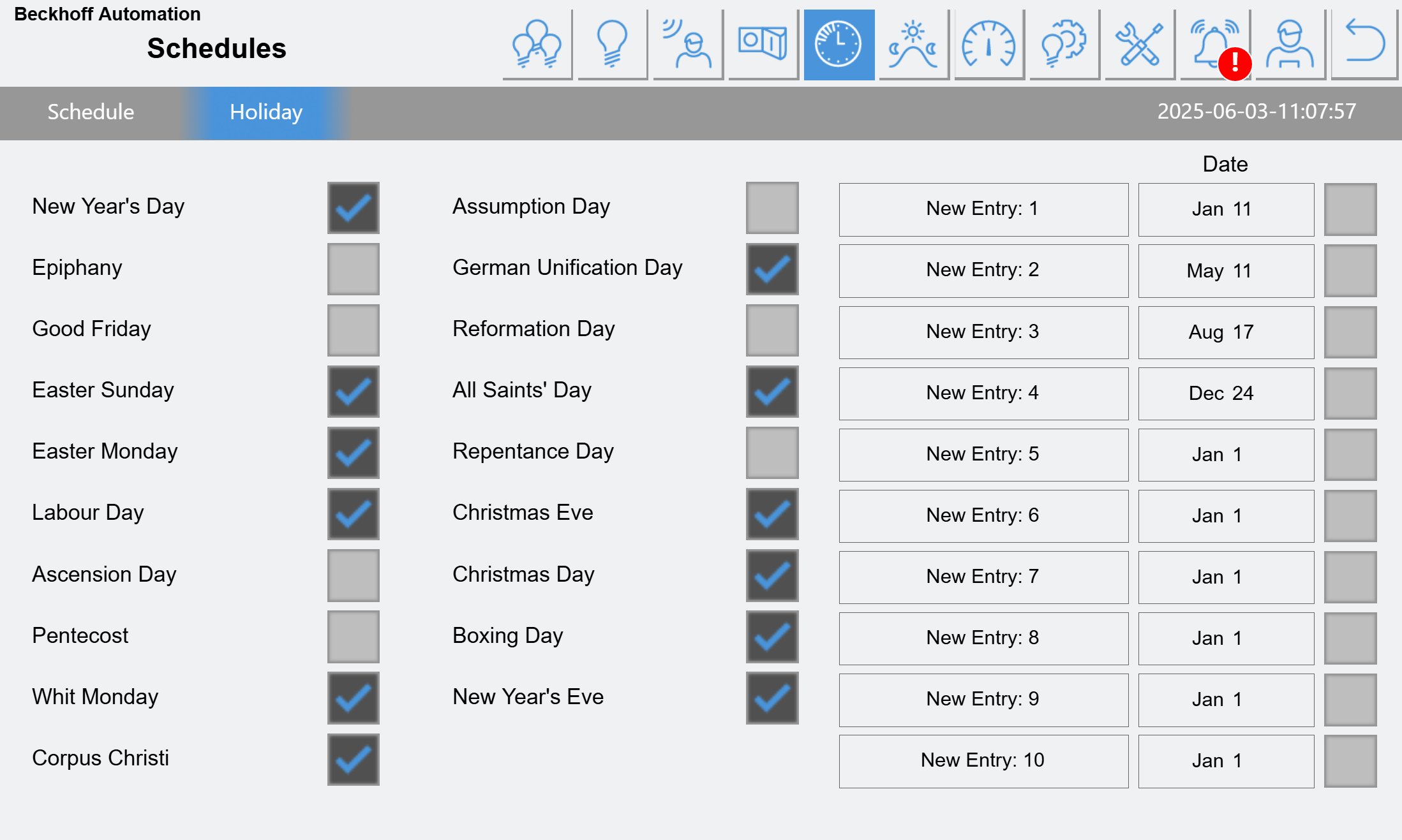

Holiday
Holidays can be activated globally on which the schedules are disabled. Common public holidays are predefined and can be activated. You can create your own individual entries in the right-hand section. Click on the date to open a calendar.
"Schedules" submenu 3:
