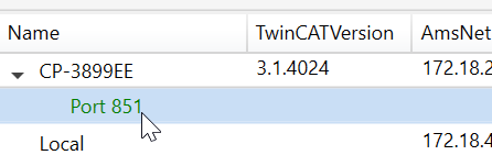

Connecting to the target system and loading a snapshot

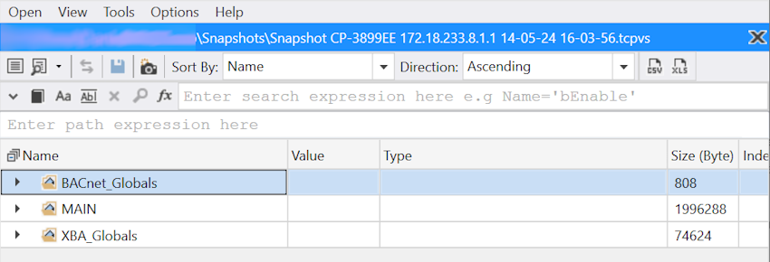

- 1. Open the snapshot with data backup of the affected target system (PLC).
- 2. Select BACnet_Globals.

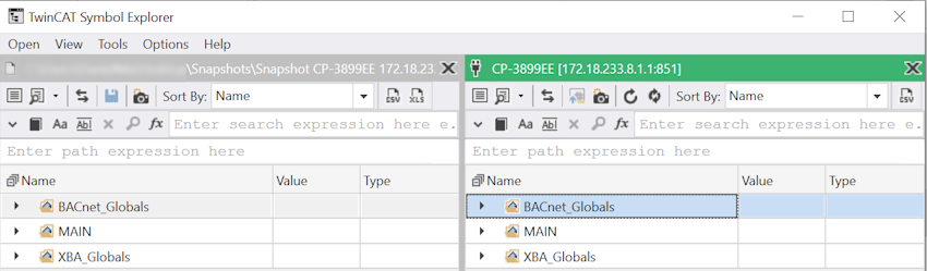

- 3. Log in to the target system in the Symbol Explorer.
Synchronize and snapshot -> target system with filtered symbols
- 1. Synchronize the data from the snapshot to the target system by clicking the Sync button in the main window of the snapshot.
- Suggestion for synchronization: 43 symbols are found for synchronization.

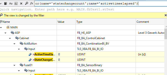

- 2. Set filters on the symbols nStateChangeCount and nActiveTimeElapsed in the snapshot.
Filter:
or(name='statechangecount';name='activetimeelapsed')

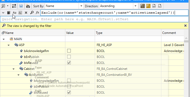

- 3. Negate the selection using the Exclude function.
- All symbols except nStateChangeCount and nActiveTimeElapsed are displayed.

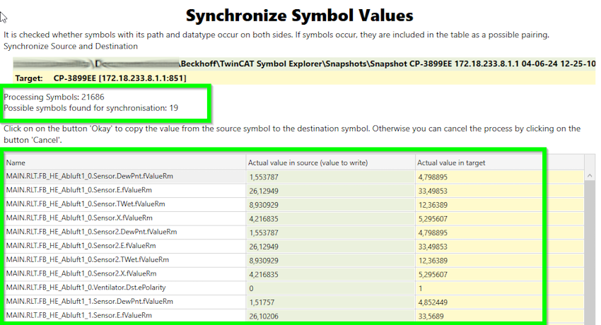

- 4. Click on the Sync button again.
- Now only 19 symbols are available for synchronization. Symbols that receive the operating data have been successfully filtered out
