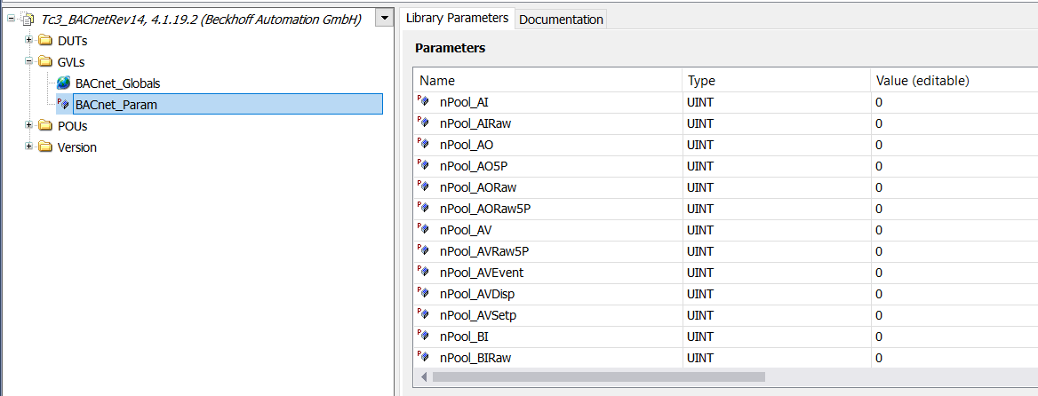

Dynamic objects are created with the __NEW operator. If the number of objects to be created is known or can be estimated at the time of the first PLC start, the library provides a predefined object pool. This is more memory efficient than using the __NEW operator. The elements named nPool_XX in the BACnet_Param section of the library GVLs can be set up to save resources.
Predefined object pool 1:
For example, if 42 instances of a FB_BACnet_AV are used, the variable nPoolAV can be set to 42 as the default value. If more objects are created than are available in the pool, the creation process will continue to use the __NEW operator.
