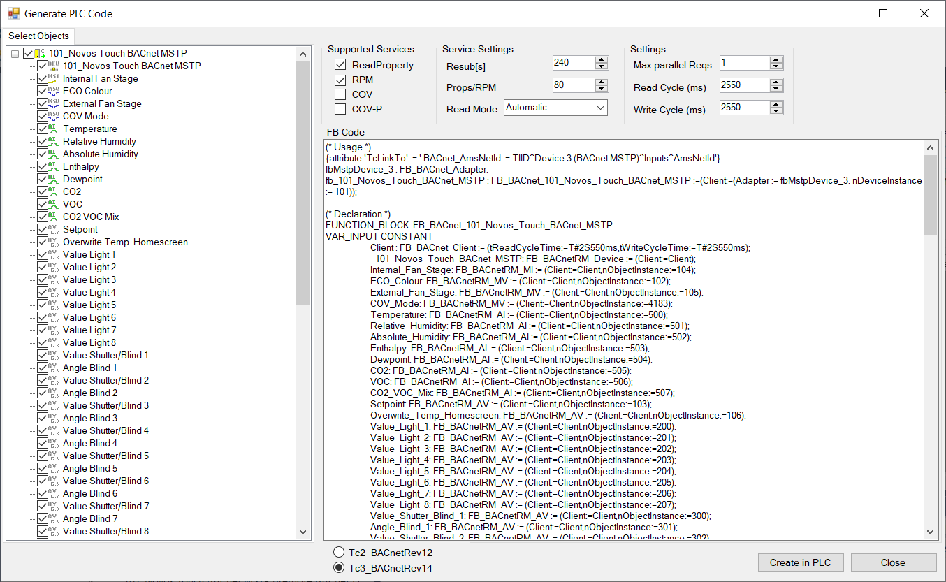

The client FB Code dialog
After calling the function FB Code the dialog shown below opens the code generation window.
The BACnet objects contained in the selected device are shown in the tree in the left window.
The client FB Code dialog 1:
If using FB Code from the Scan dialog, searching for all objects in a device may take some time. This is shown by animated dots. Please be patient to read the entire device, especially when scanning slower MS/TP devices!
The client FB Code dialog 2:
After scanning the entire device, the dialog displays all objects contained in the device.
The client FB Code dialog 3:
