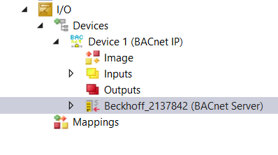

Adjusting the BACnet Server settings
1. Double click to the BACnet server which was created in the Device 1 tree item.
Adjusting the BACnet Server settings 1:
2. Use the input box BACnet ID to set the instance number of the BACnet server.
