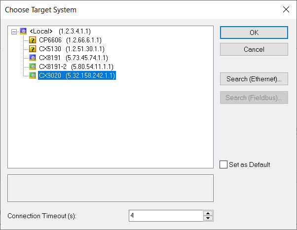

Selecting the target system
1. Select the target system from the list of controllers already connected via an ADS route.
Selecting the target system 1:

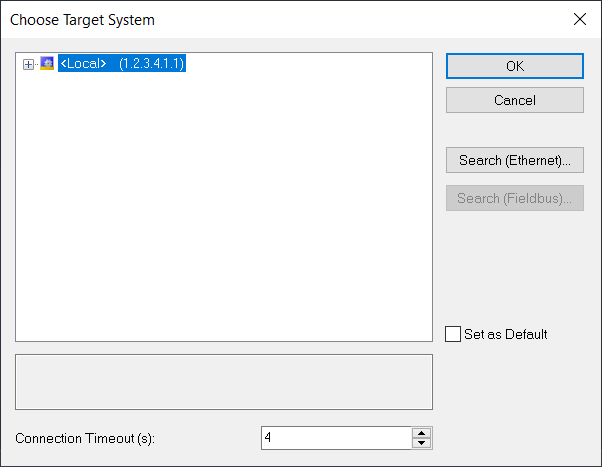

2. If no ADS route to the controller exists, select the function Choose Target System.
3. Select Search (Ethernet) in this dialog.

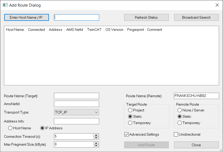

Selecting the target system 2:
4. Select Broadcast Search.

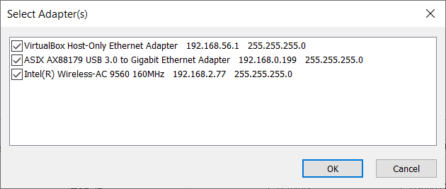

Selecting the target system 4:
5. Select the network adapters which are used to search for controllers.

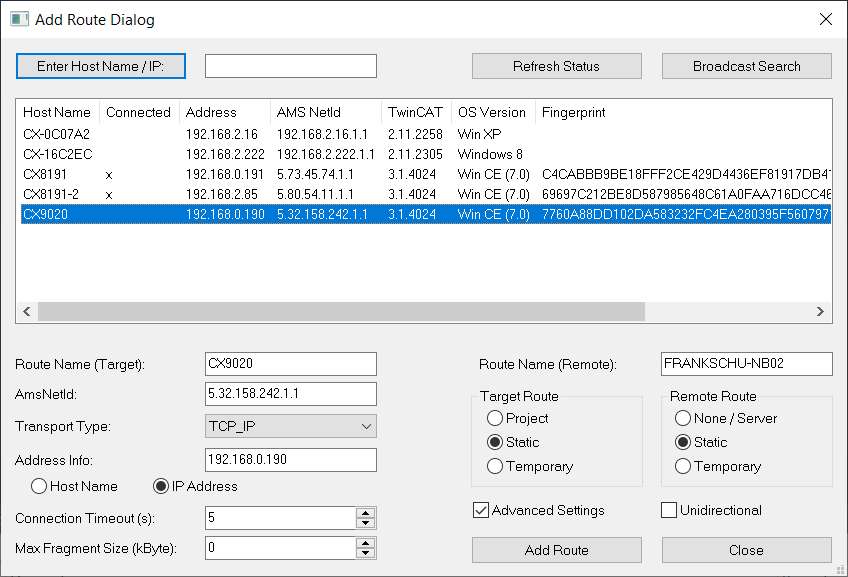

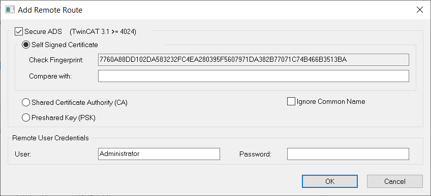

6. Select the controller to be used for the BACnet project, select IP Address in the section Address Info and select Add Route.
Selecting the target system 6:

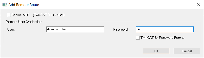

It is optionally possible to create a secure ADS route. Please refer to the Beckhoff Information System for further information how to use Secure ADS.
Selecting the target system 7:
This example uses a regular ADS route. The standard password for the user Administrator is the number 1. We strongly recommend changing the default to a more secure password and document it in the revision documents of the project, at the latest when finishing the project.
Selecting the target system 8:
The controller is now connected through ADS.

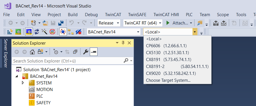

Selecting the target system 9:
7. Close the dialog and select the controller from the list of available target systems.
Selecting the target system 10:
