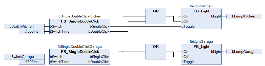

Example
In the following example, two switches are used to control two different lamps. A switch is assigned to each lamp. If a switch is pressed twice in rapid succession, both lamps are switched off.
FB_SingleDoubleClick 2:
