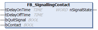

FB_SignallingContact
The two inputs tDelayOnTime and tDelayOffTime allow slow operation and slow release delays to be set. If a message signal is to be acknowledged before this time can be ended, this is done by means of the bQuitSignal input. The state of the signaling contact is communicated to the function block via the bContact input.
The state of the message signal is indicated by the nSignalState output. A message signal can adopt one of altogether 6 different states. Corresponding constants are defined in the library:

tDelayOnTime : TIME := t#100ms;
tDelayOffTime : TIME := t#100ms;
bQuitSignal : BOOL;
bContact : BOOL;tDelayOnTime: Delay before setting the message signal.
tDelayOffTime: Delay before resetting the message signal.
bQuitSignal: Input to acknowledge message signal.
bContact: Input for the signaling contact.
nSignalState : WORD;nSignalState: Message status.

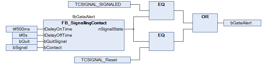

A message signal requiring acknowledgement is implemented in the following example. The variable bGateAlert represents the state of the message signal. If the output nSignalState has the value TCSIGNAL_SIGNALED or TCSIGNAL_RESET, the message is active. A positive edge at the bQuitSignal input acknowledges the message signal.
The following example illustrates the simplest case. A message signal not requiring acknowledgement.
The slow release delay allows the message signal to remain active for a certain time. The slow operation delay can be used, for example, to suppress contact bounce.
