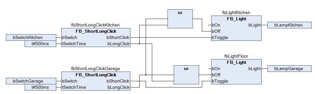

Example
In the following example, two push buttons are used to control two different lamps. A switch is assigned to each lamp. If a button is pressed for longer than 500 ms, both lamps are switched off.
FB_ShortLongClick 2:
