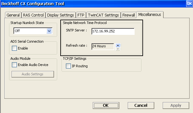

FB_HVACSetLocalTime 2:
The local NT system time can also be synchronized with a reference time with the aid of the SNTP protocol. For further information please refer to the Beckhoff Information System under: Beckhoff Information System > Industrial PC > Operating systems > CE > SNTP: Simple Network Time Protocol
