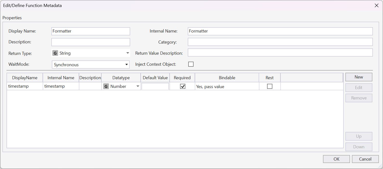

After creating the TypeScript function, a parameter of type “Number” must be created. This receives the timestamp analogous to the ImageTimestamp property of the ImageWatch control.
The function must return a value of type “String”, which is then displayed in the image list. The function is called for each list entry whenever a new timestamp needs to be displayed.

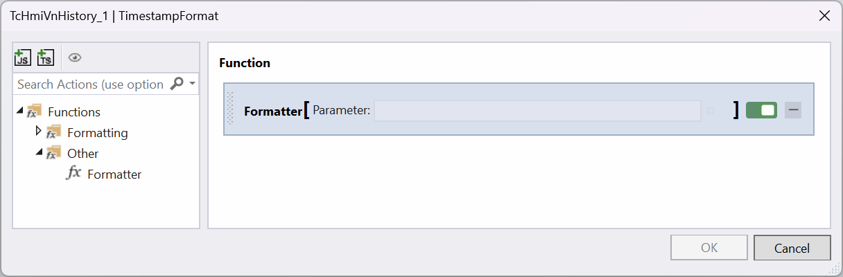

To use a formatter function you have created, click on the Select button at the TimestampFormat property and select the function you have just created in the Function Editor.
