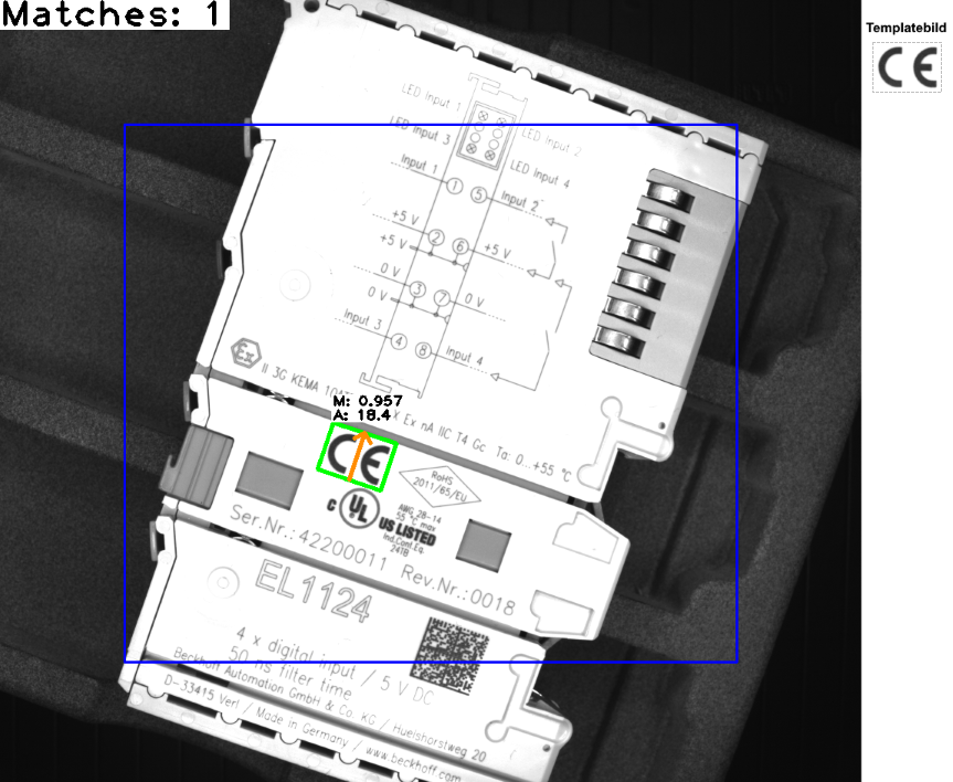

The "CE" mark is searched for as a template using the default values stored in the sample code (sTemplateFileName := 'Template01.png'):

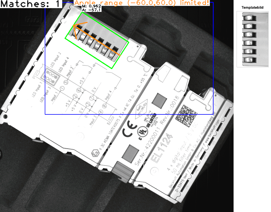

As a second use case Template03.png can be used, for example, to check via the contacts on the terminal whether the component is present, at which position and in which orientation it is located. If, for example, only orientations of ±60° are acceptable, the F_VN_FindTemplateWalshExp_AngleRange function can be used to restrict the search range in a targeted manner:
bUseRotationSteps := FALSE;
fStartAngle := -60;
fStopAngle := 60;.The ROI must be adapted accordingly and generously dimensioned so that the contacts searched for can be reliably found for all possible rotations within the permitted ±60°. At the same time, it should be kept as small as possible so as not to extend the execution time unnecessarily. In addition, the number of test angles can be significantly reduced as the search is limited to a range of just 120°, which minimizes the processing time. The following parameters have proven effective for this scenario:
// Adjusted parameters for Template03.png
stMatchingRoi.nX := 200;
stMatchingRoi.nY := 10;
stMatchingRoi.nWidth := 750;
stMatchingRoi.nHeight := 500;
fMatchThreshold := 0.94;
nProjections := 18;
nAngles := 16;
fScaleFactor := 0.2;
