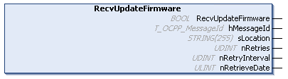

RecvUpdateFirmware

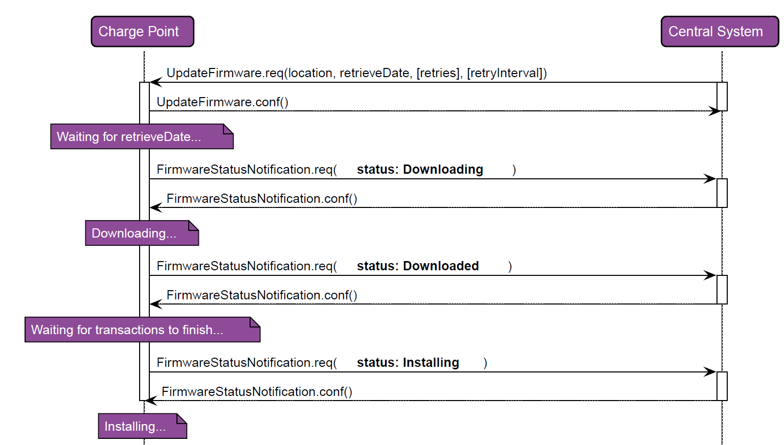

With this method, an OCPP client receives an Update Firmware request from the corresponding OCPP server. To respond to the request, the method RespUpdateFirmware must be called.
Syntax
METHOD RecvUpdateFirmware : BOOL
hMessageId : T_OCPP_MessageId;
sLocation : STRING(255);
nRetries : UDINT;
nRetryInterval : UDINT;
nRetrieveDate : ULINT;
Return value
Name | Type | Description |
RecvUpdateFirmware | BOOL | The method returns the return value TRUE if the call was successful. A method call is also considered successfully completed in the event of an error. |
Outputs
hMessageId | MessageId of the received message. | |
sLocation | STRING(255) | String with the URI from which the firmware is to be obtained. |
nRetries | UDINT | Optionally contains information on how often the Charge Point should try to download the firmware before it gives up. |
nRetryInterval | UDINT | Optionally contains the information after which time a new attempt should be made. |
nRetrieveDate | ULINT | Contains information on when the Charge Point is permitted to receive the new firmware. |
