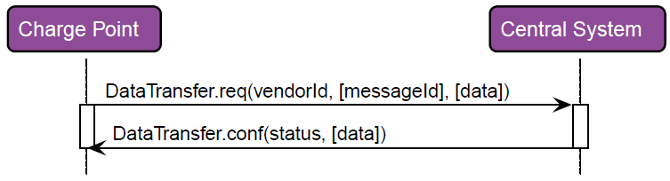

With this method, an OCPP client receives a Data Transfer request from the corresponding OCPP server. To respond to the request, the method RespDataTransfer must be called.
