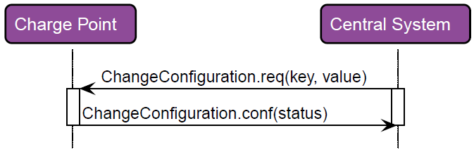

RecvChangeConfiguration
RecvChangeConfiguration 1:
With this method, an OCPP client receives a Change Configuration request from the corresponding OCPP server. To respond to the request, the method RespChangeConfiguration must be called.
