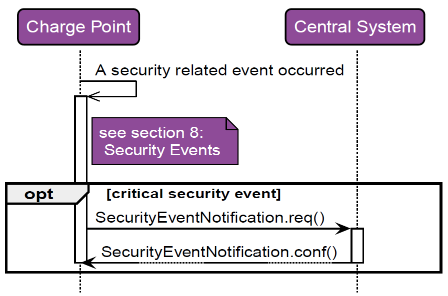

With this method, an OCPP client sends a Security Event Notification to the corresponding OCPP server. The response from the OCPP server is processed directly within the method.

The method returns the return value TRUE if the call was successful. A method call is also considered successfully completed in the event of an error.
