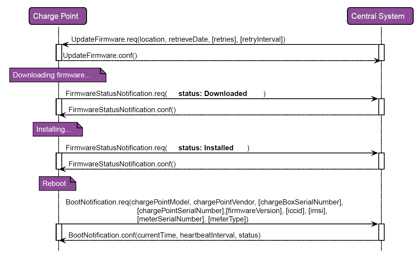

SendUpdateFirmware
SendUpdateFirmware 1:
With this method, an OCPP server sends an Update Firmware request to the connected OCPP client. The response from the OCPP client is processed directly within the method.
SendUpdateFirmware 2:
Syntax
METHOD SendUpdateFirmware : BOOL
    sLocation      : STRING(255);
    nRetries       : UDINT := 0;
    nRetryInterval : UDINT := 0;
    nRetrieveDate  : ULINT;
SendUpdateFirmware 3: Return value
Type
SendUpdateFirmware
The method returns the return value TRUE if the call was successful. A method call is also considered successfully completed in the event of an error.
SendUpdateFirmware 4: Inputs
Type
sLocation
STRING(255)
URI from which the firmware is to be retrieved.
nRetries
UDINT
Number of attempts to download the firmware again if the download fails.
nRetryInterval
UDINT
Time after which the download is attempted again.
nRetrieveDate
ULINT
Time and date from which the Charge Point may receive the new firmware.
